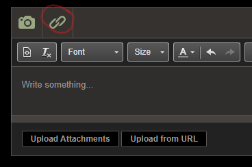

      To embed youtube you need to use this button now. Unfortunately it doesn't exist when editing an existing post as far as I know.
      Your pictures also aren't showing up for me. Looks like they're trying to link from within r3v somewhere, but it doesn't seem to be working.
        well that's a bummer. I've tried attaching files by uploading, from url - with the image icon.. and directly by writing img src = etc
        in some ways it would save me a lot of time not to do this, but I kind of want to document the project - anyone have ideas?
        on my end everything shows correctly, all the images - but when I open a new tab in incognito (ie not logged in) they all do not show.

          I use flickr to store/host my images.
          Just from reading the first two posts, it sounds like an awesome project. Hopefully you get the display issue resolved so we can see it. :-)

            hey thanks man, I use flickr also .. I guess I was trying to use the forums upload photo feature instead of copy/paste direct links.
            IDK why that was so difficult... hopefully the rest of this project goes easier ! (lol)
