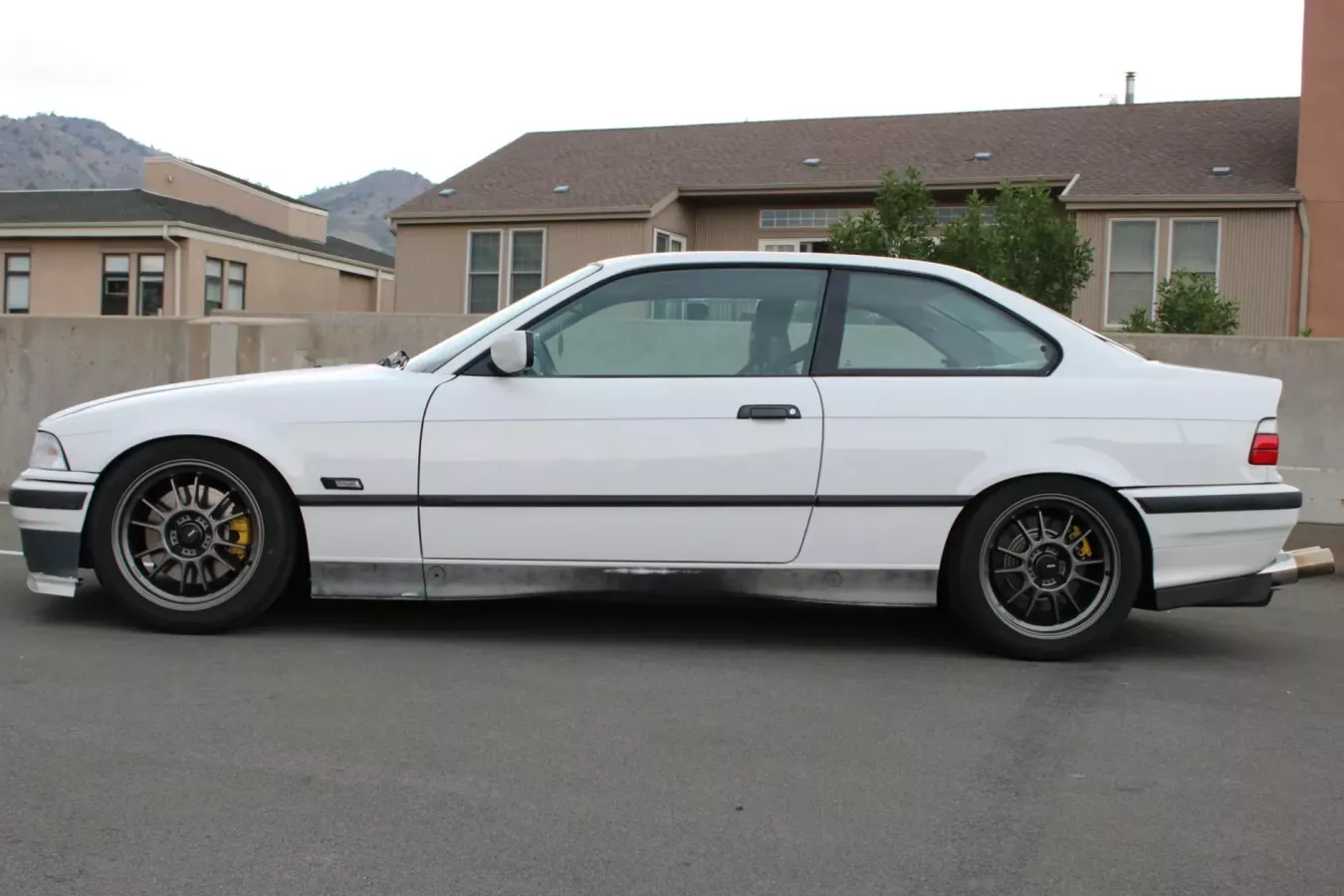

                        OSAH racing - Yeah, you are totally right, BUT like you said, I'm almost through it. I knew it had potential to be a complicated process. Anyways, as for the E36 track car, I actually ended up selling it in December. I hadn't been able to do a track day in over a year and I'm saving up to buy a Ford Transit van this year for work (carpentry). Also, the car was actually in that perfect sweet spot of being prime to sell. Everything worked, consumables like brakes/tires still had life left, I hadn't spun it into a wall. I will say though, that car was such a blast on track and I would recommend you get one 100%
                        And I did. This 325is is a project so to speak but what we have is bushing upgrade, fresh M50, rebuilt head Schrick 264, M3 front and rear subframes and a euro 6 speed from the e46M3. Starting a build page this winter.
