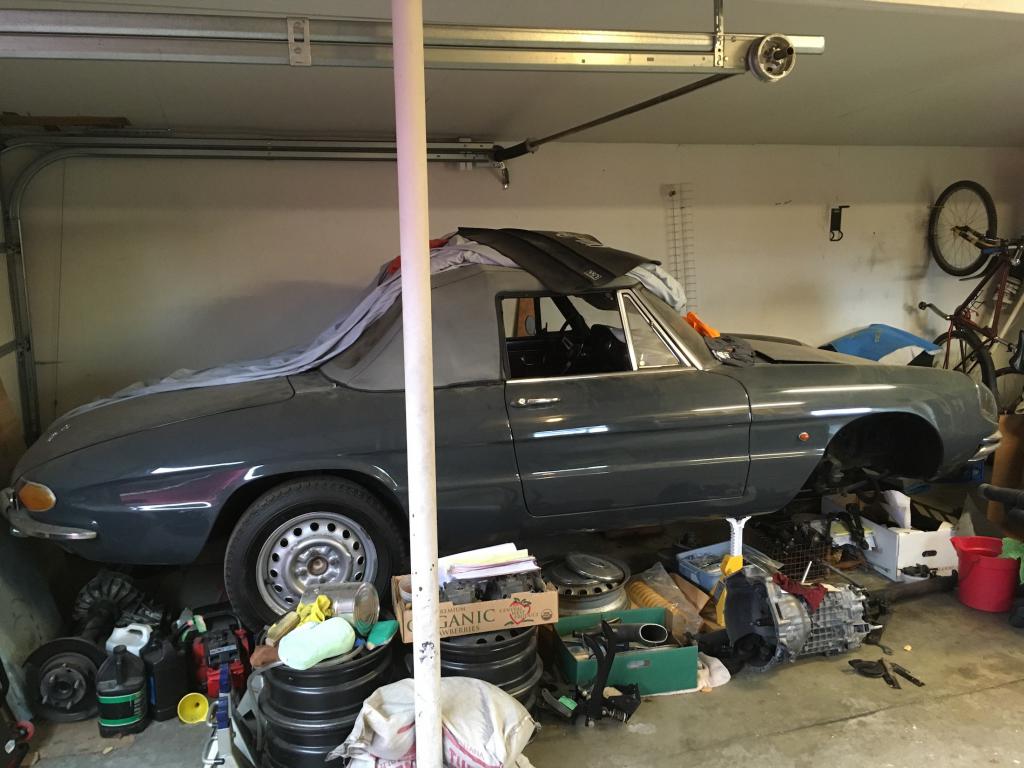

        (Note new rear axle sitting on the floor, yellow springs, no front suspension, Webers in a cardboard box, as well as an E30 transmission waiting it's turn)

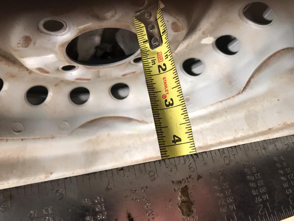

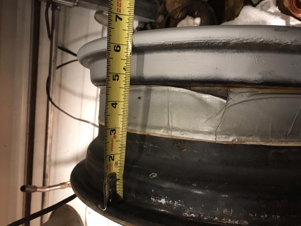

                    Opinions on these possible wheels please -
                    I am fine with easily reversible mods on a car like this. They designed them in the 50s and 60s for windy rough mountain roads in Italy. They had long wheel travel and softish springs. The engineers built specials, and "sports purpose," and race cars much lower and stiffer.
                    So I'll keep my original, painfully skinny 4.5x15 wheels for originality, for historic shows, future value, whatever... But I want it to sit down lower and wider for everyday. I have Centerline yellow springs going on, better shocks, all new bushings.
                    I'd been thinking for years about widening an extra set of factory steelies to 6 or 6.5 x15, with original hubcaps about level with the lip instead of sticking out like Ben-Hur's hubs. It should look like a factory special, not deep dish hot rod - that make sense? Finding an old school hot rod shop that still does that is tough. Liability blah blah. Lack of demand blah. The phreshkid here had some nice ones done in Mexico for his 2002s. A 195 fits on a 6 or a 6.5" wheel. Everything I read says except for racing, a 205 is too much on the chassis and the antique steering box. 7" is too deep and too much tire on a 1900 lb car.

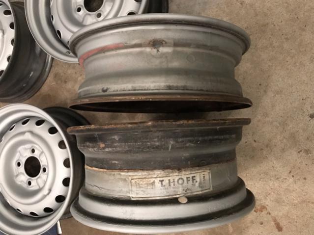

                    So I found a guy looking for original 4.5x15s because his PO widened his to 6", and he's doing a perfectly correct restoration of an early GT.

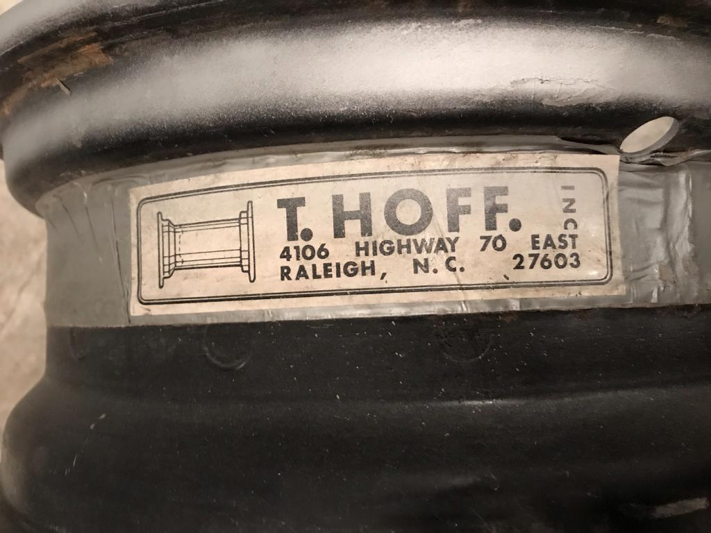

                    They seem to have been done by an old machine shop in NC. I see seam sealing. They're banded, so original barrels and centers for hubcaps. He said they balanced and rode fine the few times he drove it before stripping it down.

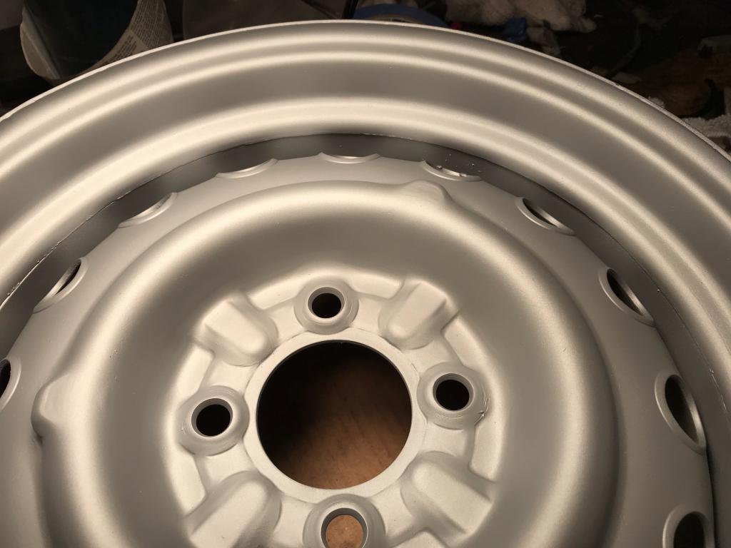

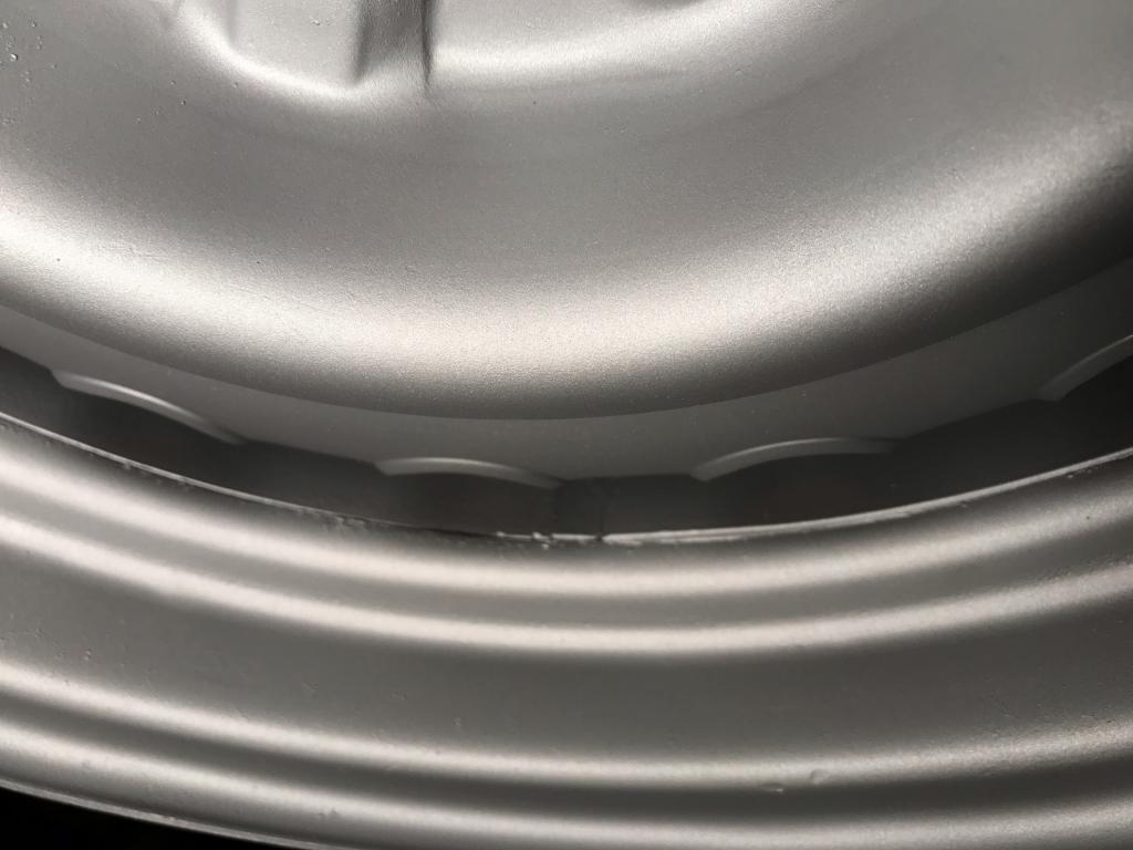

                    My concern is this exposed butt joint on the outer face. Maybe the welding was done from the backside. But I would think you'd want to fill or weld-in these joints and grind them smooth and repaint.

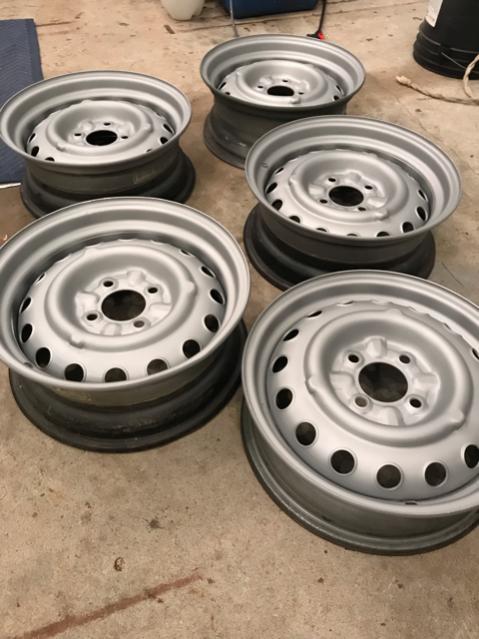

                    The four to the upper left, compared to a stock one lower right. I'm figuring out the offset now.

                    6" vs 4.5"

                    See that seam where the band meets the barrel?
                    And here.. I see the butt joint of the band here.

                          I haven't inspected a banded wheel from that side but I've seen it being done and it is done from the outside usually with a special rig that turns the wheel and MIGs it in one smooth bead. It makes sense that there would be a visible seam on the inside of the wheel, maybe finishing on the inside with a sanding wheel was not done, probably because it isn't visible once it's on the car. If you post a picture of the weld itself I'm sure one of the internet weld critics will chime in and tell you if it's underpenetrated or something.

                            Here's what I've got so far. A seam sealer and tape layer over the weld...

                                OK, pics are loading today again.
                                Here are more pics the seller sent -
                                I figure the offset at about 19mm. OEM skinnies are 38.

                                This car won't be tracked, and it's mostly for fun drives over the mountains, so they won't be overly stressed.
