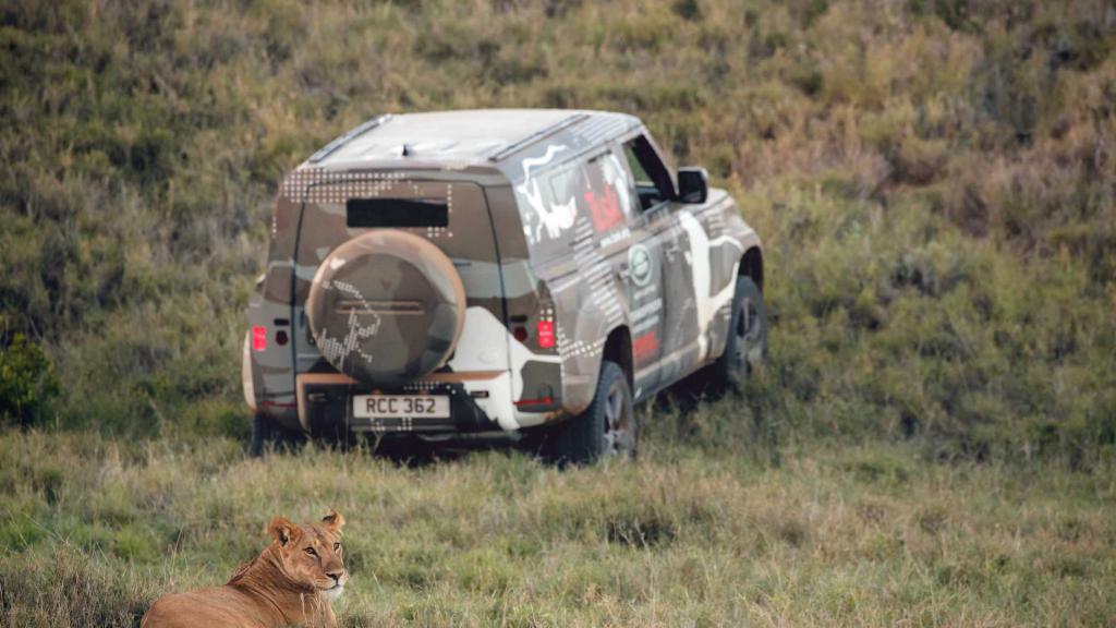

              Seems to be working today.....

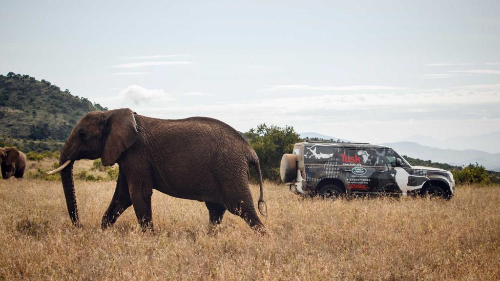

              Defender testing in Africa. This outfit tracks and tags lions for wildlife research, so they have to go where the lions go, not the roads. It's right out of Mutual of Omaha's Wild Kingdom! They were always chasing some beast while hanging out of an old Land Rover.

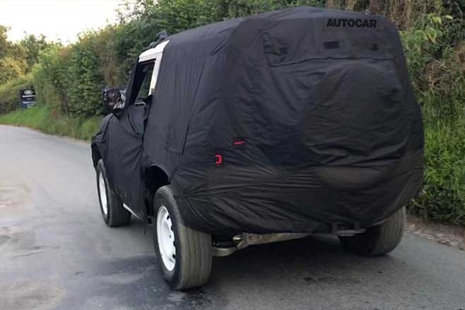

                      More info leaked -
                      Project Code L663
                      Coil springs.....with air suspension optional. Air susp will be more capable.
                      Temperature monitors in the adaptive dampers.
                      Electronic locking diffs.
                      Heavy reinforced subframes, control arms, ball joints, bushings.
                      18" wheel standard, with options to 22". AT and mud terrain available.
                      There appears to be a steel-wheeled base spec version available.
                      Heavy testing into chassis stiffness, speaks and rattles.
                      "Land Rover’s Andy Deeks, product engineering team leader for durability and reliability -
                      "...we elected to use the same aluminium model platform as the other bigger Land Rover models use. It’s called ‘D7U’. The platform has been through a programme of wide-ranging design and engineering overhaul – but it’s a monocoque. It’s relatively light and very stiff, and those are attributes we need. But there’s no ladder frame here, and we don’t have rigid axles.”
                      "Deeks explains, “there are reinforced suspension subframes, as well as new stronger suspension arms, ball joints and bushes. We’ve got bigger wheel arches, more suspension travel, more wheel articulation and more ground clearance than on any other Land Rover. This car was designed to exceed the usual Land Rover capability targets that our other models are engineered up to. And it has been engineered for better durability and reliability than any car that Land Rover has ever made.” "
                      “We know what reputation our cars have, and what some people will expect and say about the Defender,” he says. “This is a much more complicated car than the old one, that’s true. Engineering in the durability, the capability and the lightness we wanted would have been easier with less complexity. But nobody said this would be an easy car to make.”
                      “It’s not a car of the same simplicity as the original, granted. It has its own character. But it’s easily tough and capable enough to be worthy of the name: more than, in both cases. The old Defender was a car that was durable because it simply wasn’t comfortable enough to drive it quickly off-road. This new one absolutely is – and trust me, it can take whatever punishment you’re prepared to ask of it.”

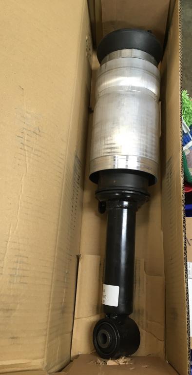

                          We narrowed down a leak in the RF strut bellows, so we decided to change it out. Pretty simple - 3 top strut nuts, an air fitting, and a big bolt through the lower control arm. Well, this bolt is apparently famous for not coming out. Smooth bolt through a smooth steel sleeve in the bushing, down in the weather and slop, and they bond together. Why would you assemble this thing without a bunch of anti-seize or something?
                          It's 9" x 5/8 or 3/4 ø. 24mm nut, 21mm bolt head. We buzzed the nut off with an impact. The bolt will not budge. It will turn over 90 degrees with a breaker bar and a pipe, but all you're doing is twisting the rubber bushing. It's not moving out of that sleeve. We've impact gunned, sledge hammered (mushroomed the end of the bolt), breaker barred, torched, PB Blasted, let it sit....nothing.
                          Click image for larger version  Name:	IMG_5253.JPG Views:	0 Size:	50.2 KB ID:	9905550
                          Click image for larger version  Name:	IMG_5254.JPG Views:	0 Size:	47.4 KB ID:	9905551
                          Click image for larger version  Name:	IMG_5255.JPG Views:	0 Size:	33.3 KB ID:	9905552
                          The steel sleeve - when this goes back together, that will be buttered with anti-seize!

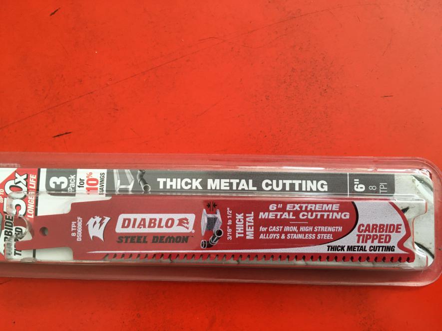

                          I went and got these. I think a sawzall from underneath the control arm, and these blades, and we just cut the bolt on both sides of the strut. We ordered a new bolt and nut.

                            Define torched? Like a propane or mapp gas, or do you have a oxy fuel rig? Mapp might get it hot enough to get the rubber bushing to weaken enough to allow you drive it out with a hammer.
                            Since it sounds like you have destroyed the end of the bolt with a hammer ( when whacking a bolt with a hammer more than a couple times leave the nut on it threaded to just flush so it protects the threads). from the control arm photo, is there a bit of a lip on the bottom side of the control arm like there is on the top? If so cut the mashed up end of the bolt off as square as you can, go rent a the biggest bushing press you can find (looks like a really beefed up C-Clamp) POUR THE HEAT TO IT get it red if you can, then use the press to get the bolt shank started moving, (since the head side of the bolt is in a recess on the other side it should be enough to get broke lose) and then you should be able to drive it the rest of the way out with a big ass drift punch.

                              Propane.
                              Bolt head changing color.
                              Both sides of bushing smoking. Just trying to expand and contract the bolt so it'll suck in some PB.
                              Doesn't do you any good to get the bushing out - the steel sleeve won't come through the control arm. The bolt ø is exactly the control arm hole size for alignment accuracy.
                              Threads are not ruined. There is about an inch and a half of necked-down bolt end much smaller than the threads. Hex shape. I can sacrifice that end. Even just started on loose, the nut is over an inch back from the end - you can't hammer on it. I read about hammer on hammer technique - not sure why that has any effect unless you can't hit a bolt square.
                              I've seen c clamp solutions - it doesn't feel like anything would be able to "push" it apart. I just saw a video of a LR shop where they couldn't get these same size bolts out of the control arm bushings with air hammers or anything. They cut the legs of the control arm off (1/4" steel) with a disk cutter so they could get the cutter wheel on the bolt and cut it.

                                Ahhh gotcha, on the bolt type, I know just what you are talking about. The press will work once the inner bushing sleeve gets bound up against the inner edge of the control arms smaller hole. You may have to break the system down and reheat once you get it lose from the rubber part and then continue on with the press, A traditional C-Clamp will not generate the needed force, that C- Style press should capable of 10-12+ tons of clamping force if you push your luck with a 2 foot breaker bar applying the torque, that would be dangerous though and I highly doubt it would take that much to get it to budge with a liberal enough application of the heat. You could also try to get the bolt good and hot then rapid quenching the bolt shaft while under tension from the press (or big C clamp if thats all you have access to, with the sleeve of the bushing pushed up against the inside of the control arm. The rapid contraction associated with the cooling of the bolt shaft and even moderate tension might get to dis bond as well. You might have to get a bit more heat on the situation than propane can generate, Mapp gas is a good home gamers alternative to an oxy fuel rig, but that might be what it takes to get things up to the temps needed fast enough before you heat soak everything else as well.
                                As to hammer on hammer, it transfers the force of the hammer blow, but dampens the sudden impact forces that is the main cause of the deformation of what ever your whacking, as the hammer in the middle takes the impact force and just transfers it to the stuck bolt. Think about the balls on string when you pull one back and let it go, and hits the other 5 and the one on the other end is the only one, that moves, same idea. Wear some impact rated glasses when whacking hardened steel together its dangerous as it can fragment, do you have 4lb brass mallet? My 1st go to for anything like this is my 4lb brass mallet
