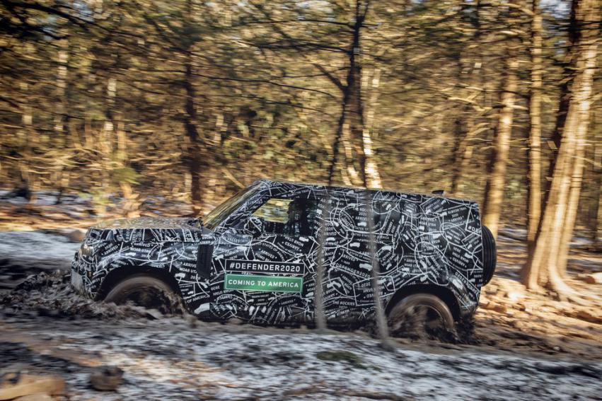

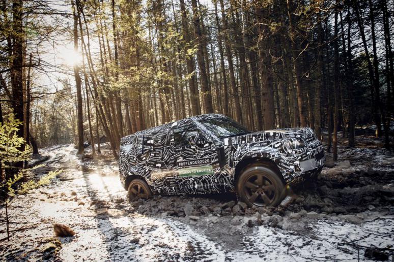

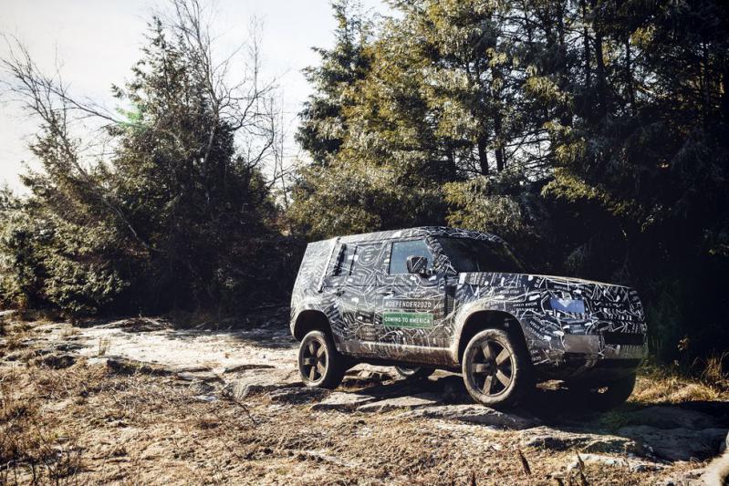

    Testing in North America starts first of the year.
