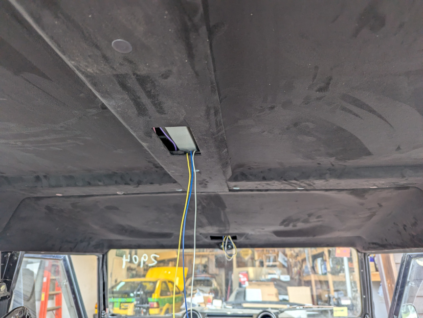

    But it's finally starting to come together.
