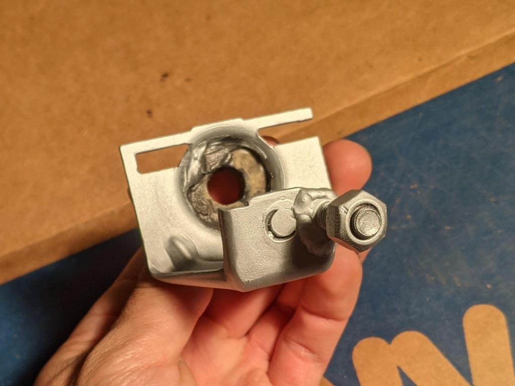

              Oh on a totally separate note, you had offset your shifter carrier, you suggested I try that to help center mine. Plus I slotted the bracket.. I have a photo somewhere.. anyway it worked, wanted to say thanks.
              Edit: this thing! I wish I moved it over a hair further.
              Click image for larger version  Name:	54CP9kZ.jpg Views:	0 Size:	63.4 KB ID:	10041915​
                  Yeah I MIGed the exhaust, 308L wire with 304 everything else. Welds are kind of ugly (lack of skill, used pipe, .035 wire seemed hard to get the speed right, other excuses), but it's been almost 6 years with the car living outdoors in Canada with no signs of rust, so I'm happy with it.
                  Since then, I bought a TIG. I used that for downpipe alterations, and the finished product is a lot prettier and easier to manage heat to prevent warping vbands and whatnot (I still clamp the crap out of them though)
                  Glad the carrier piece tip worked out. I still have that setup in my car, but I think I want to try a chassis mount at some point (maybe when I ditch the crappy ebay short shifter?).
