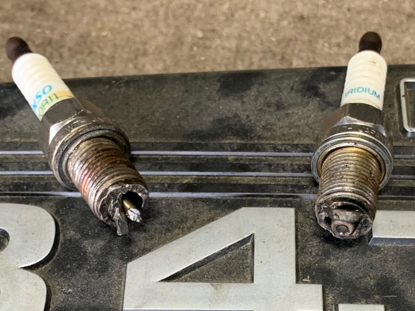

                  Well boys. She's fucking fucked mate. Tore down the engine to slap a belt on a time it up to see what needed to be done. Cams wouldn't turn more than a few degrees. Crank still was stuck, only turning about 10 degrees.
                  So I did what I should have done in the first place. Pulled a plug. Cylinder 1. Then I tried cylinder 3....tried... So I pulled cylinder 2.
                  1 and two are DEMOLISHED. Three wouldn't come out. From what I can tell the belt was done once (truck has 209k on it). Rollers and WP are all free and smooth, but the tensioner was fully depressed and stuck down. I think it wasn't replaced when the belt was done. So I'm looking for an engine now. Anyone know of any yards within a few hours of central Va with a 2005+ 2uz VVTI?

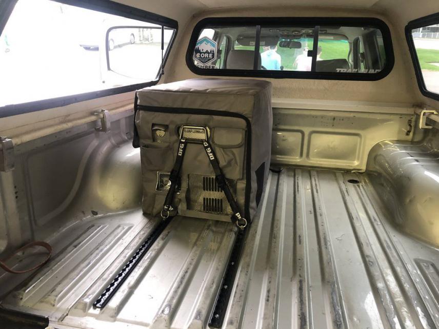

                        Switched up my truck setup recently. Got rid of the RTT and moved to a Crashpad swag and a topper. Got to test it out this weekend and I'm super happy with it. I also installed a second battery and a fridge in the bed. That's the biggest life changer tbh

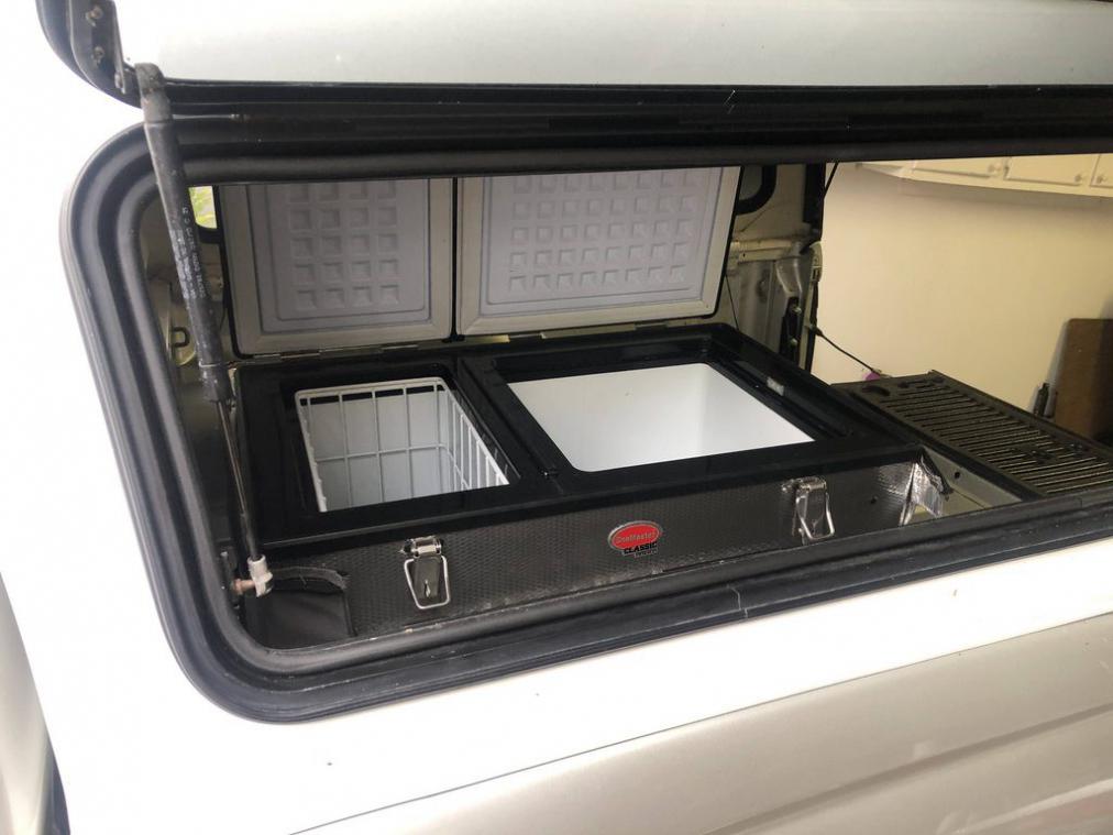

                              Here's the plan for the next setup in the back of the LX:
                              Still working out what fridge can work in that spot, how high the platform will be, etc.
                              More on that front soonish.
