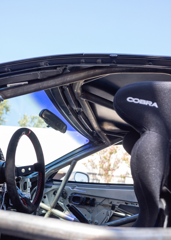

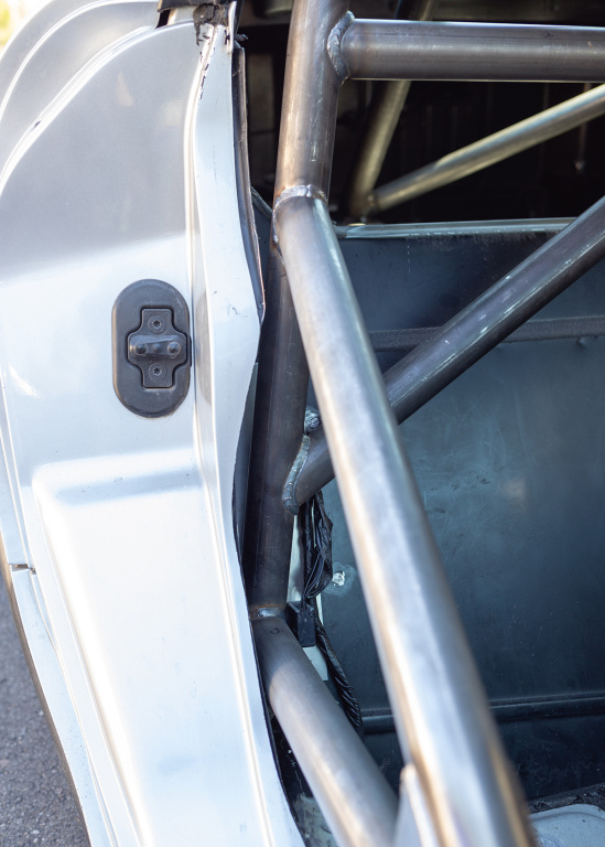

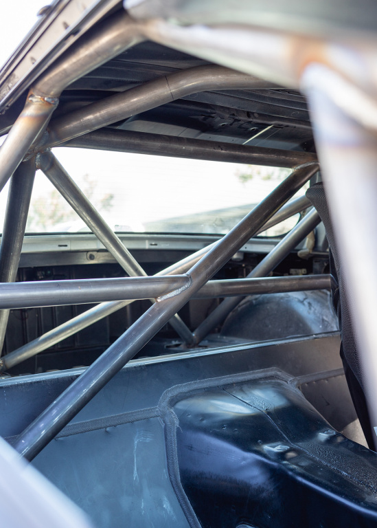

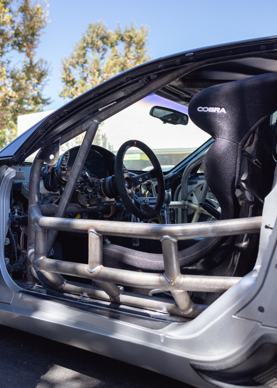

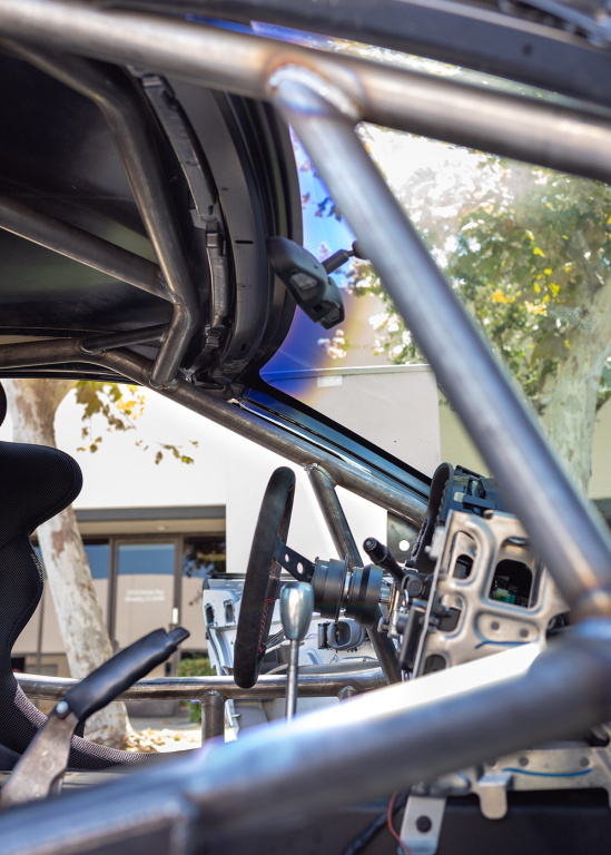

    The biggest gain we've achieved with this design is the headroom. This particular cage doesn't go as high as our later versions, but what you can see is how the AP bar by the driver's head is pushed up into a pocket I cut out of the roof. It's fiberglass, so there's no strength lost by cutting into it. And surprisingly, I haven't seen others do this. It's ideal real estate to bend a bar up there, which is great because it can better protect the driver by being that far up.
    The other great improvement about this design is how the Main Hoop is welded directly on top of the frame of the car. If you aren't familiar with Corvettes, they're kind of like trucks, where they have two large frame rails that run the length of the car. It's a fine design, it works. But most cage builders will weld the bars to the side of the frame, or worse, on top of the gas tank sheet metal. They do that because the frame is obscured by many other metal panels, so it's easier to just... not do it the right way. My boss was adamant about increasing passenger space and tying into the strongest parts of the car, so that's what we did.
    This set of photos doesn't quite show those details, but I have plenty more to come.

    I have not much to add. I like very much the OP's wire welding skills presented here in the pictures.
    FIA rules that we are following in Europe use X-bar for doors. They are so used in forest rallies (notably in WRC) etc so they should be good for serious side impacts too, but I run out of skills if needed to estimate if the approach is right or not.
