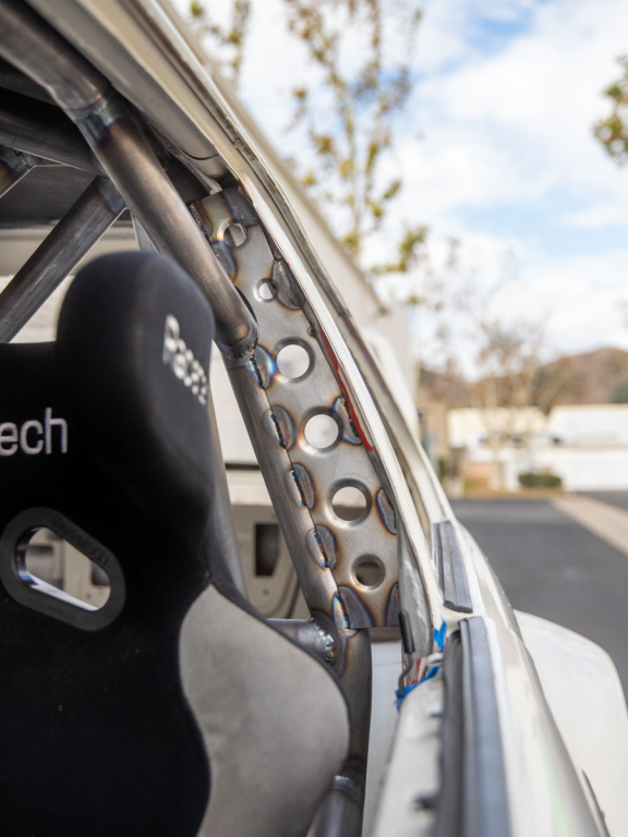

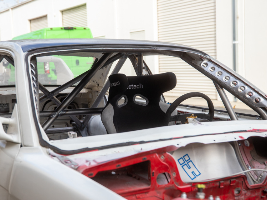

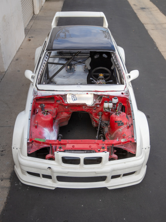

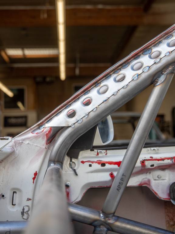

    Leave a comment:

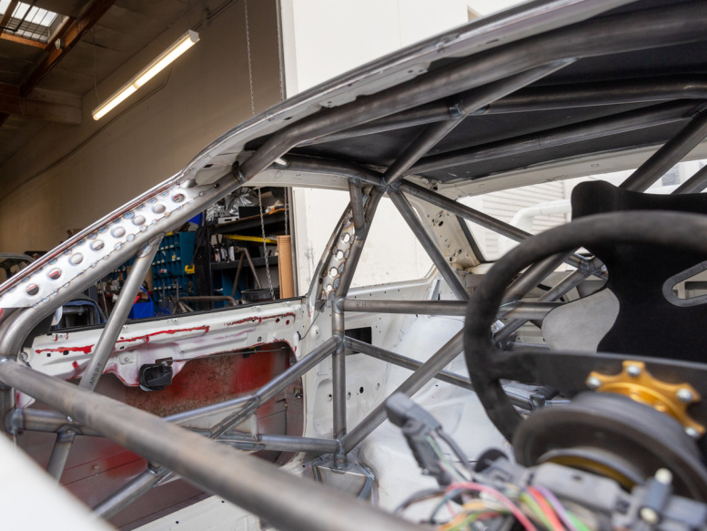

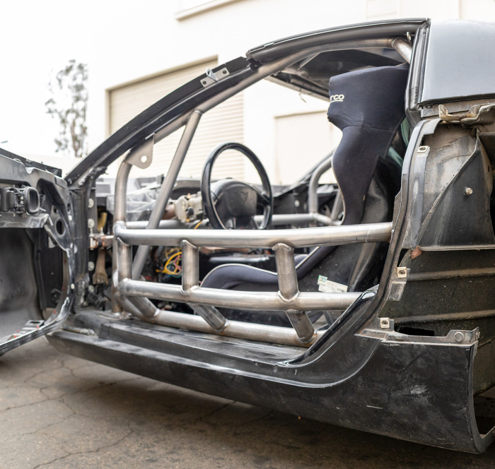

  • Chilezen
    replied
    Click image for larger version  Name:	BE36-6613.jpg Views:	0 Size:	195.2 KB ID:	10112103
    Click image for larger version  Name:	BE36-6620.jpg Views:	0 Size:	184.5 KB ID:	10112104
    Click image for larger version  Name:	BE36-6622.jpg Views:	0 Size:	192.3 KB ID:	10112105
    Click image for larger version  Name:	BE36-6554.jpg Views:	0 Size:	197.5 KB ID:	10112106
    Click image for larger version  Name:	BE36-6551.jpg Views:	0 Size:	196.8 KB ID:	10112107

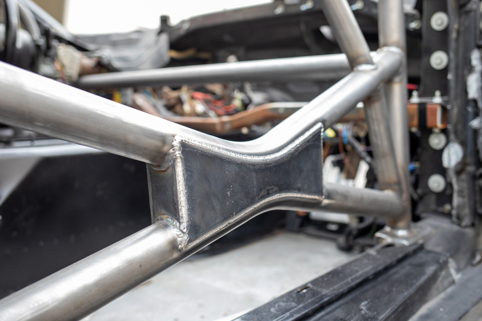

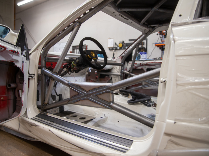

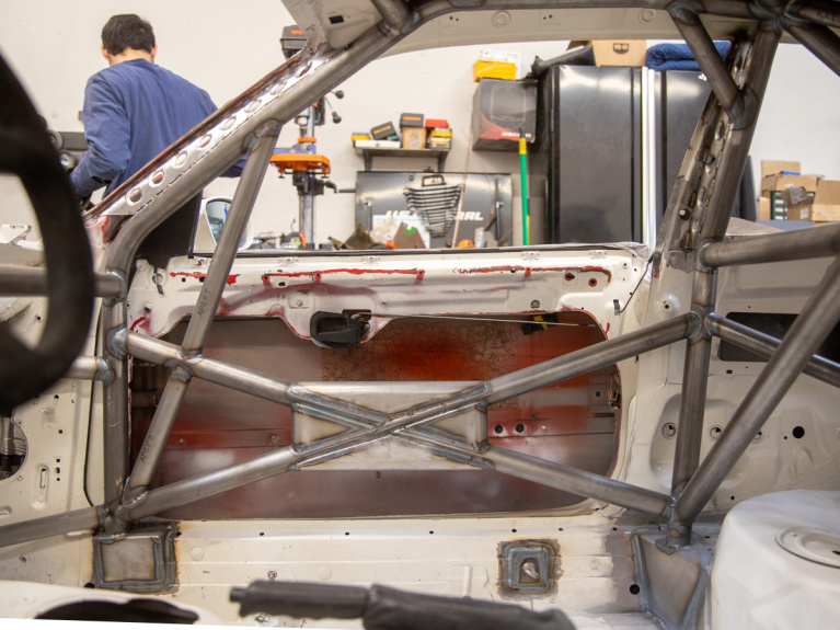

    Personally, I'm not a fan of this type of door bars, but this is what the customer wanted, and we delivered. Making the large taco gussets for the doors was a chore, because our die/press isn't wide enough to make that as one piece, so it was built as two halves. In a production sense, incredibly time consuming to weld and blend the halves, four times.
    Credit due to the welder who welded all of this. Wasn't me, I just design the cages now. This guy comes in any time we have an in-house build.

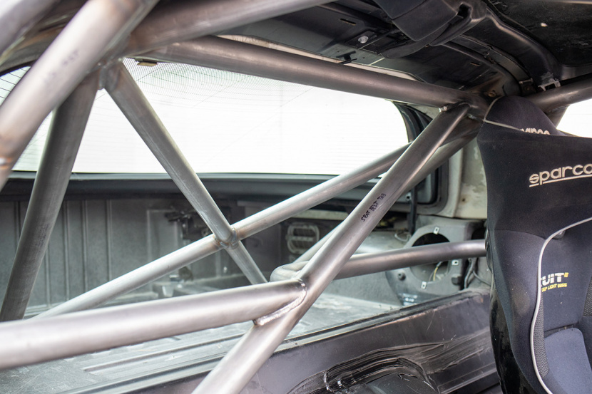

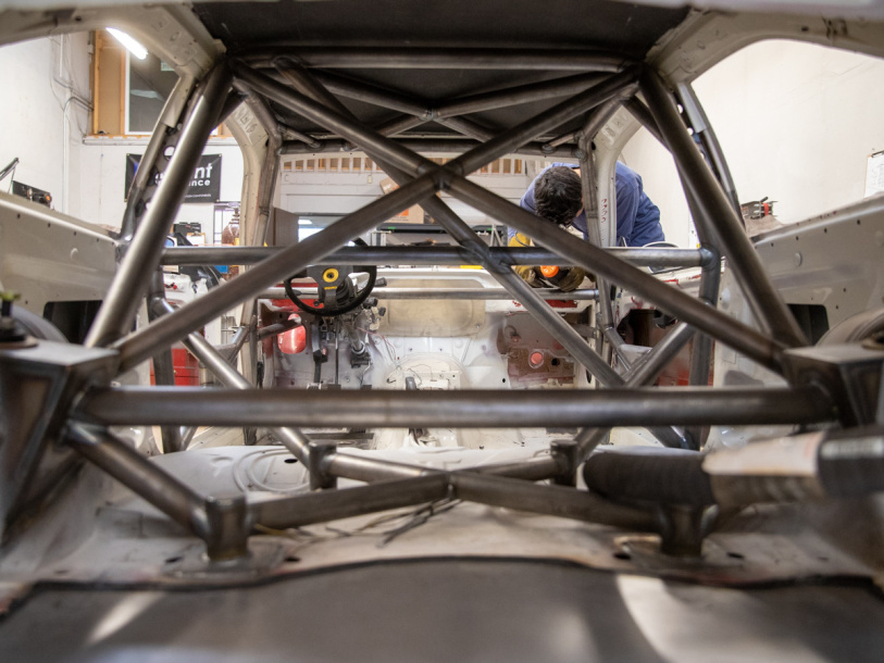

  • Chilezen
    replied

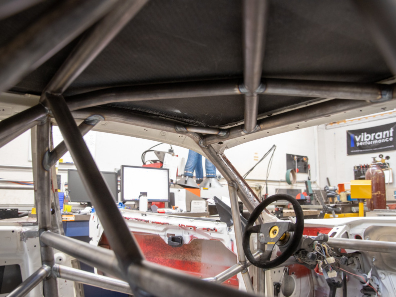

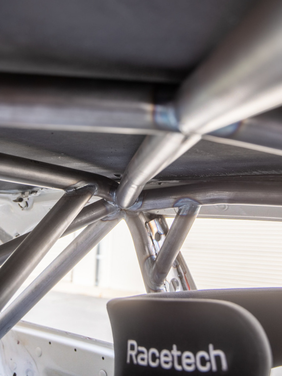

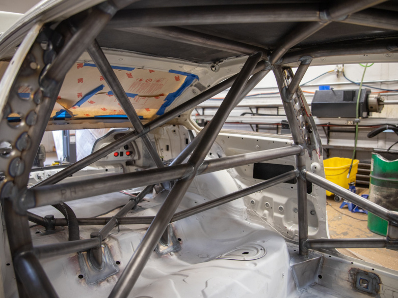

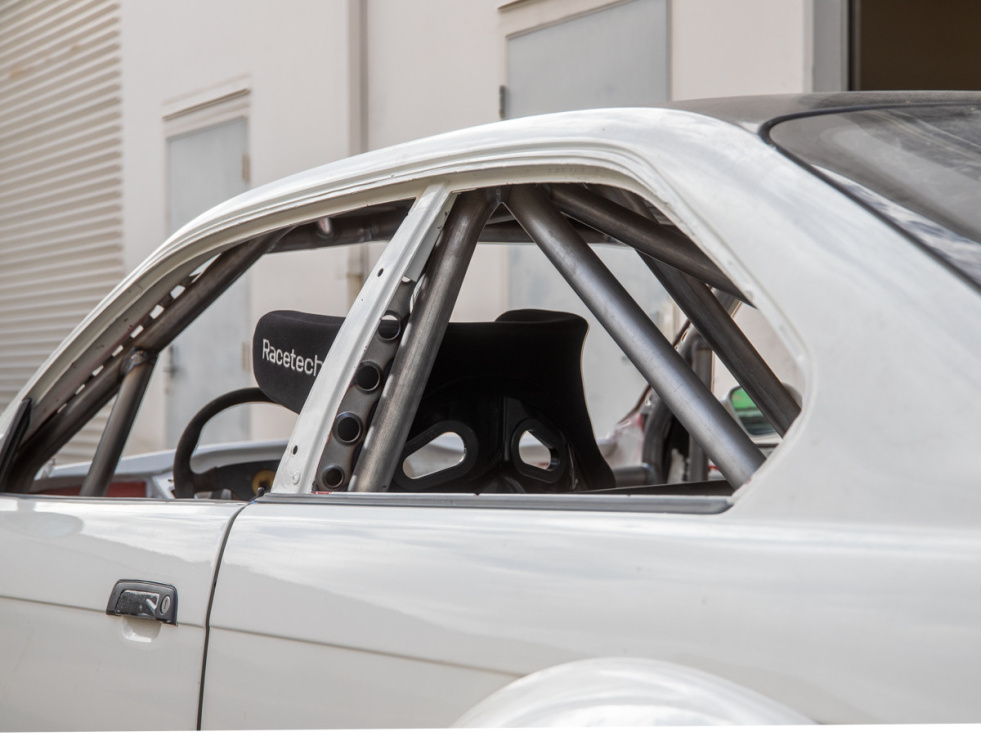

    I've been slackin'. I'm ready to post some more builds!

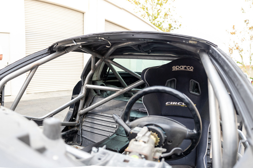

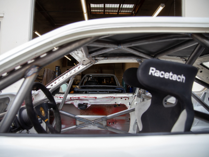

  • Chilezen
    replied

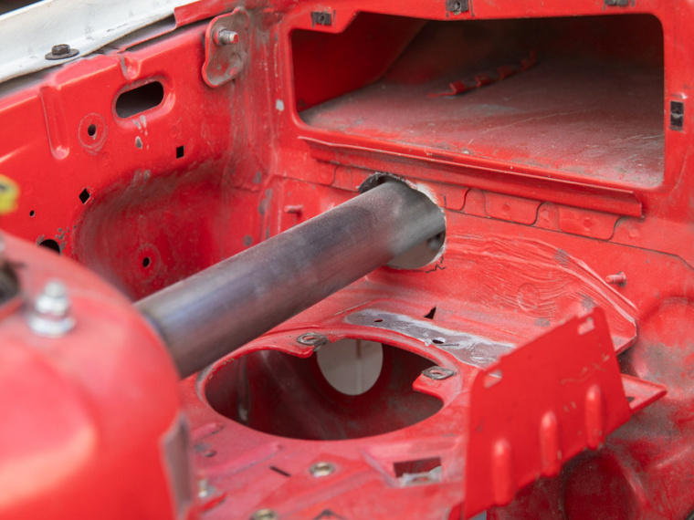

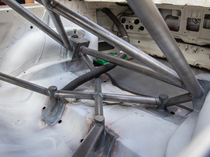

  • Chilezen
    replied

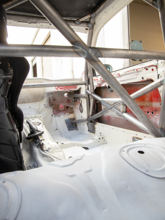

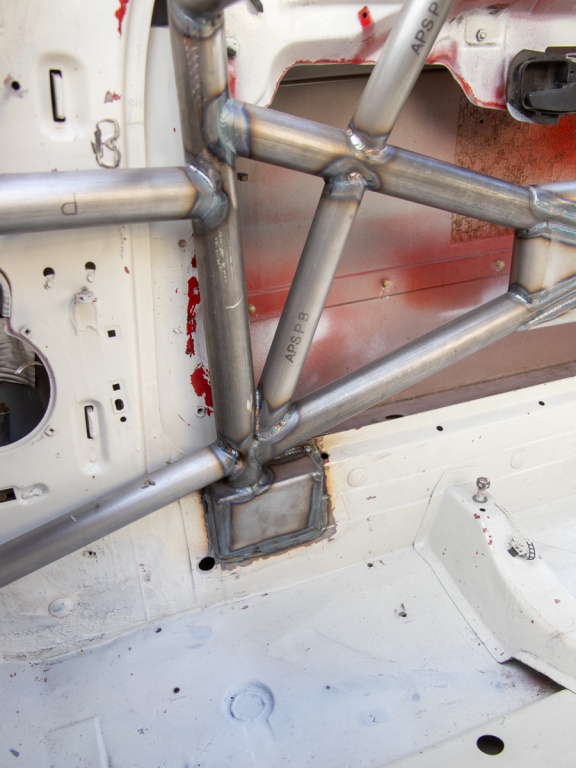

    This set of photos hopefully shows you more of what the previous set didn't.
    Click image for larger version  Name:	C5_Olie-8423.jpg Views:	0 Size:	185.4 KB ID:	10097774
    Click image for larger version  Name:	C5_Olie-8430.jpg Views:	0 Size:	187.5 KB ID:	10097775
    There, in the bottom left, you can clearly see the cutout in the body where the Main Hoop terminates. It sits directly on top of the frame.
    I could show you what other cages in this car look like, but I'm not here to disrespect other builder's designs.
