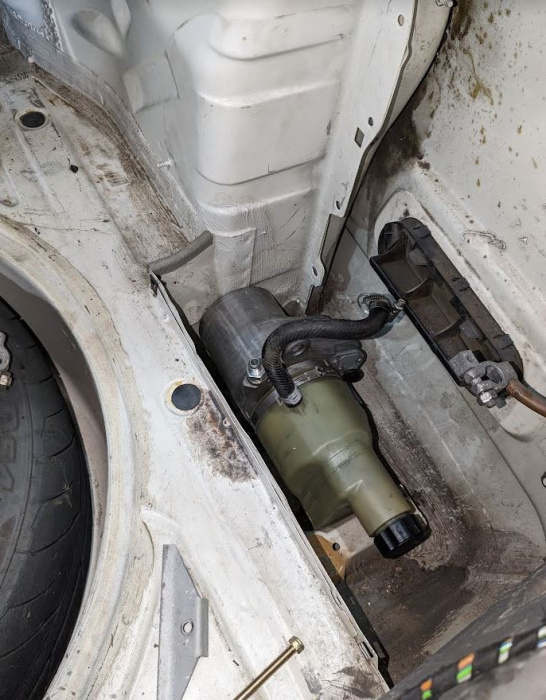

    I briefly mentioned this in the Mk60 post, but when I ran the independent rear brake lines I also ran the 3/8 AN6 tubing for a trunk mounted pump unit (highlighted red). My motivation is that even though I mostly got the PS temps under control at the track and it feels great, 275F is still pretty warm and it will decrease my rack life and it still likes to vent. Plus, having just the alternator as my only belt-driven accessory is glorious! Also, 2hp! (or 5... depending on who you ask)
    The front is literally just two hoses that connect the tubing to the rack. So clean!
    Still working on the final configuration for the rear, but the AN6 bulkhead fittings pop-up in the corner of the trunk giving me lot of flexibility. I had though of just mounting the pump in the back of the trunk, and I could, but I think I'll take the opportunity to relocated the battery back there (going to an Optima 35 at the same time to save 8lbs...).
    I'll have a combination of hardlines and softlines to put the pump in the battery tray. I'll mount it vertically at first, using the stock battery tray, and eventually make it horizontal so it will sit under a cover. (The Mazda pumps work really good for this because they have remote reservoirs) Pictured is a Volvo pump.
    I've already got the speed controller circuitry figured-out and it's just a $20 Arduino board that I will upgrade to also respond to Vss.
    All of my old front PS stuff, including Chase Base reservoir, pump and brackets weighed like 12lbs, the pump weighs about 15lbs.
    This is all un-doable so if it sucks I'll let you know...

    trunk..
