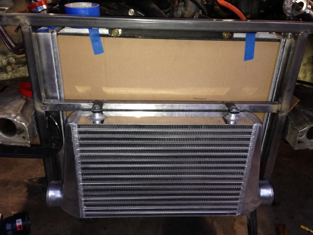

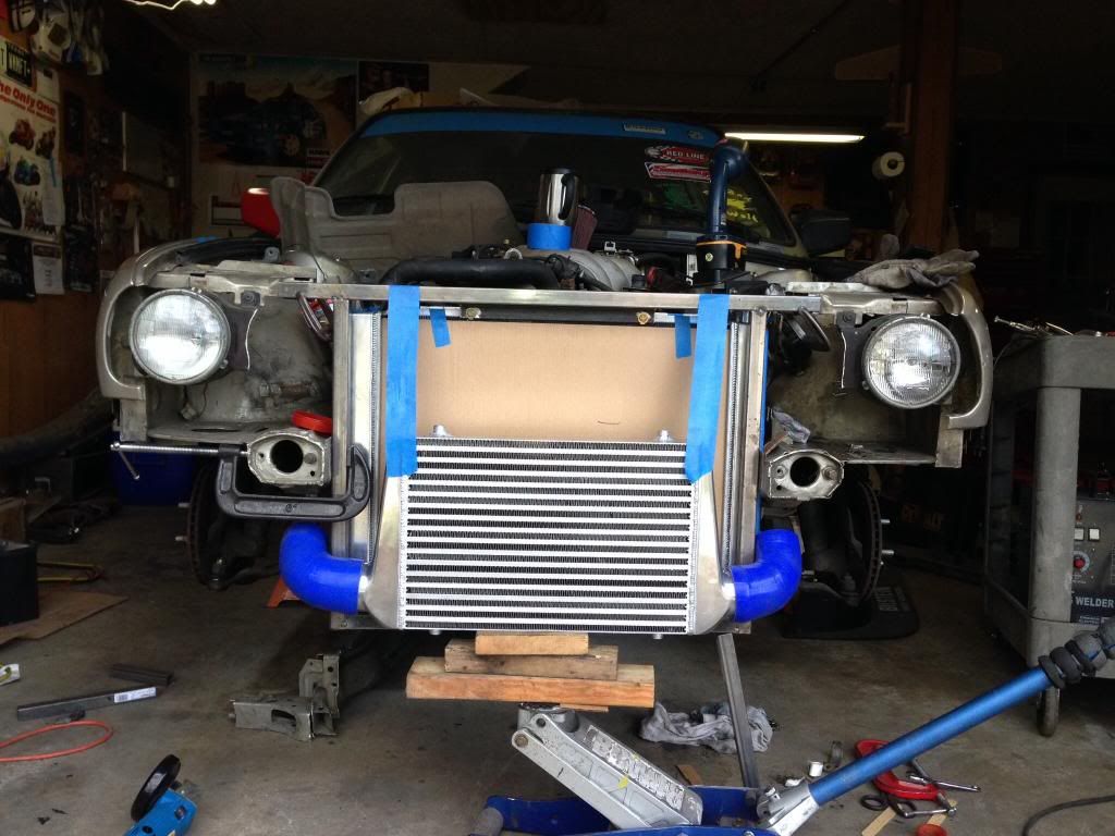

    Most of front cage finished....radiator mounted.......intercooler positioned.

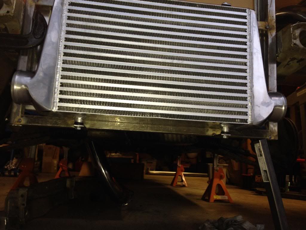

          http://
          Lower intercooler mounts

          • Jeff Schaadt
            • Jul 2013
            • 141
            #95
            http://
            Top mount, tacked in place.....1/4" rubber bushings on top/bottom mounts.

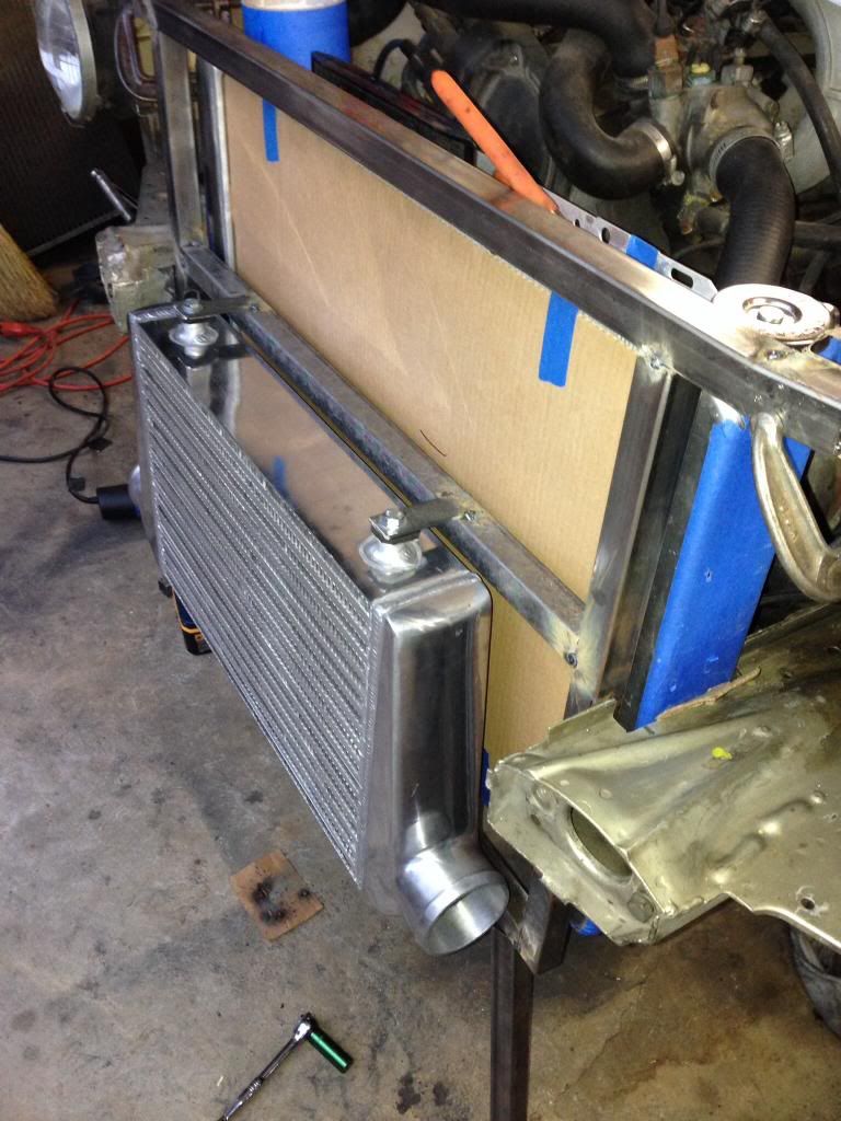

              #96
              http://
              Another angle

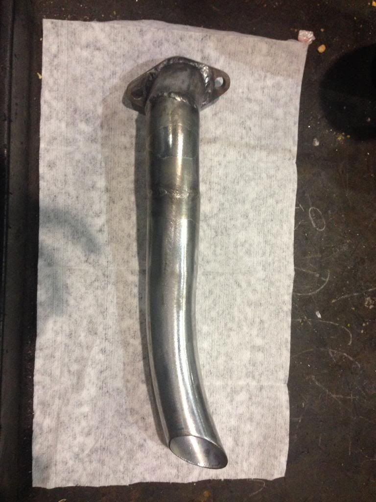

                            #103
                            http://
                            Wastegate dump tube Tig'd up. One thing I find very satisfying, is the fabrication aspect of a race car build. It would be easy to buy the parts or pay someone to build what was needed, but I prefer to do it myself.
