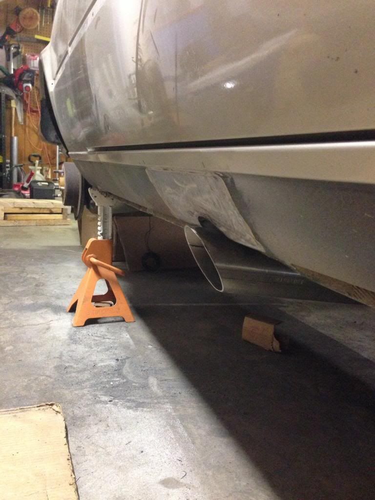

      Exhaust exiting passenger side, tucked up just a bit.

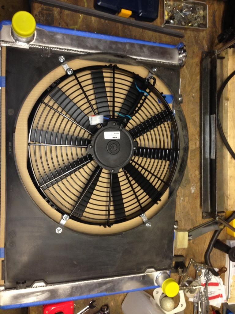

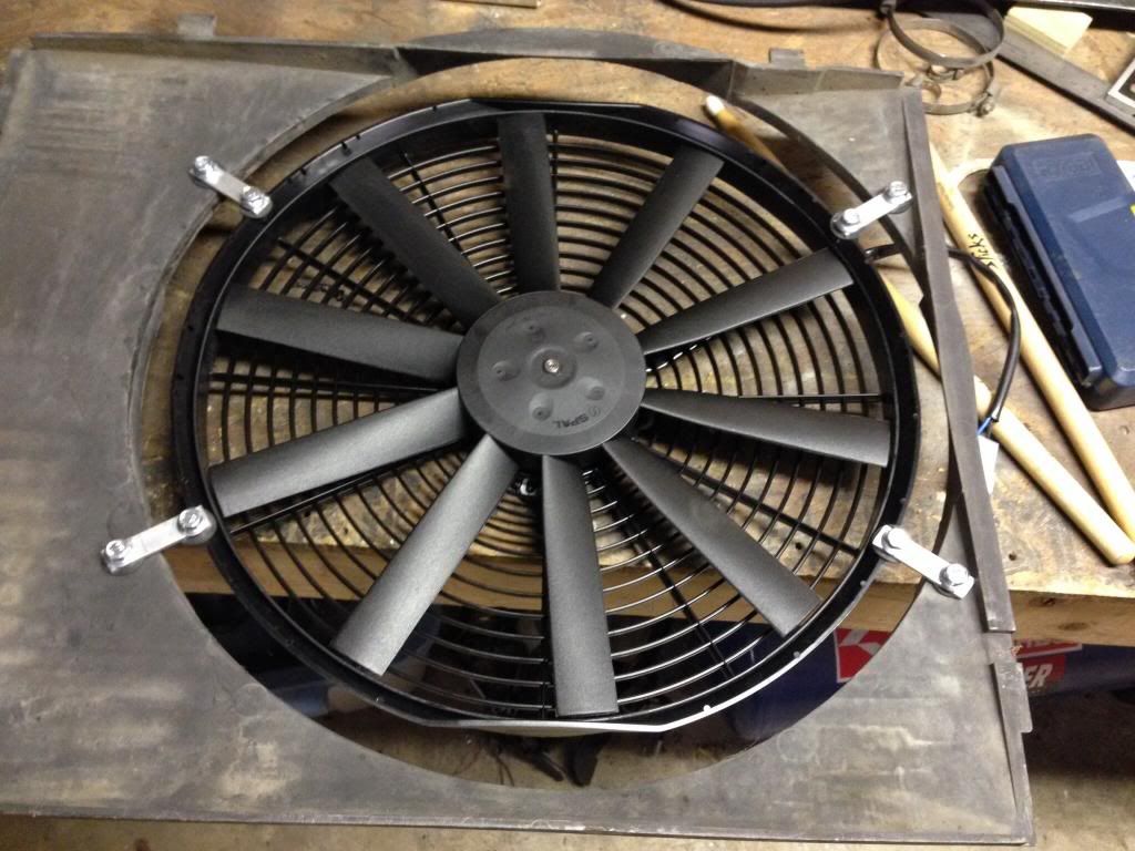

          Beemer fan shroud fits aluminum radiator very well.

              #111
              Originally posted by Jeff Schaadt
              http://
              Did you have to cut very deep into the car to get decent clearance with the exhaust?

                  #113
                  Iron freak, only had to cut on the door sill, prolly 1.5", I believe I used 5" or 6" exhaust tubing as a filler. The underside of the chassis has a nice recess where the exhaust could tuck up nicely.

                    #114
                    I have a very similar plan so I was curious. I was thinking about bringing it out the side a little higher but this seems to be a simpler option.

                      #115
                      Yes, check the underside floor pan for the recess, it's almost like that's what it's there for....FYI, the surrounding sheet metal where I cut through is very thin........ Or you could do like Tim Hardy and exit behind and above the front tire, coming through the fender..... Coming off the turbo, he has about 2 foot of exhaust. Very nice and mean looking setup.
