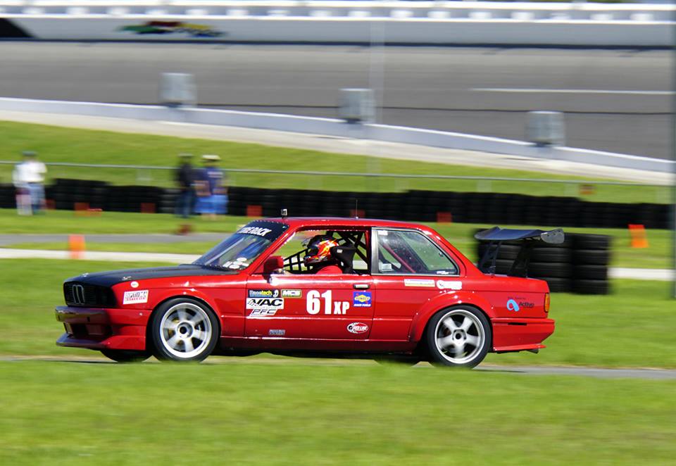

                  If you guys want to watch, this guy has a really good set of videos on aerodynamics
                  • wingnut1961
                    • May 2015
                    • 9
                    #69
                    I just got into this E30 and am AX'g it while I sort things out and get my comp license. Interestingly, it came with a large CF GT wing (69 in. wide) that the previous owner used in NASA GTS. It was too wide and mounted too far back for SCCA so I pulled it off the car during my first AX day. After adding the wing back on for the next AX, (narrowed to 61 in. and moved forward 3 in.) I noticed my brake bias was thrown off (locking fronts) after adjusting it to the no-wing position. This was only noticeable at the end of sections with 50-60 mph speeds. Just throwing out that data point...
                    • team9
                      • 82
                      #70
                      just fyi....your wing is on backwards....
                      Mark K
                      1989 BMW 325i
                      SCCA SEDIV TT Street Mod Champion 2011
                      • wingnut1961
                        • May 2015
                        • 9
                        #71
                        Yeah. PO had it mounted that way. I swapped it around...
