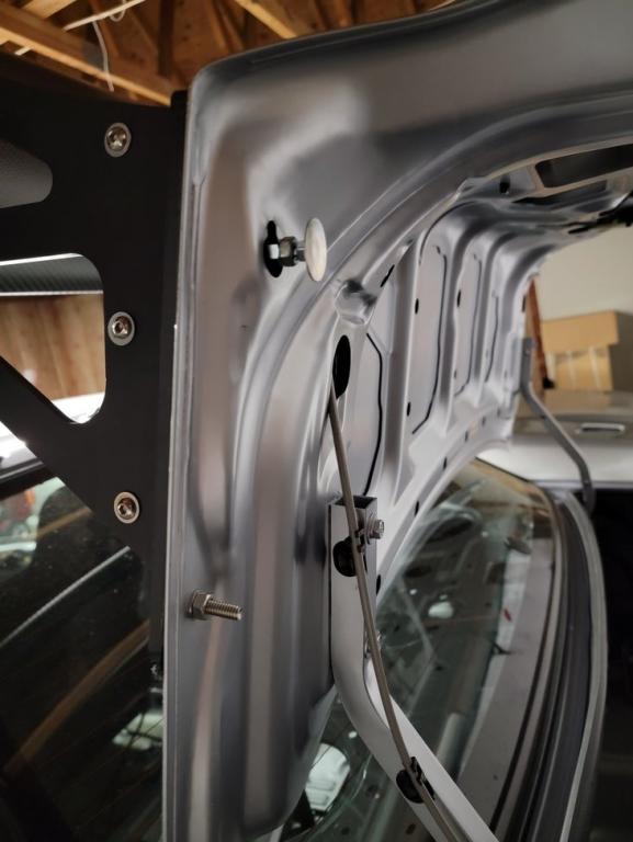

        Evo's are notorious for folding the trunk lids with a lot of rear down force. This is actually an on going discussion on the evo board. A lot of guys replace the rubber trunk stoppers with an elevator bolt and then replace the forward wing mount bolt with a hood pin through the frame. Keeps the front from lifting and the rear from folding down. I think the e30 trunk lid has more structure to it though. Its certainly heavier. Click image for larger version

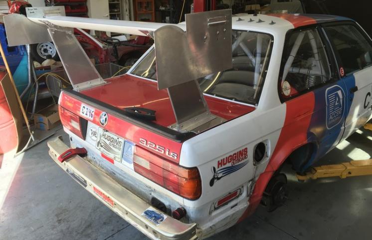

          This wing has 20,000 race miles on it on this chassis and this trunklid with multiple tire wall impacts. Trunklid is good to go. I have to readjust the rubber trunk stoppers after each race but thats it.

            I might try that elevator bolt idea for the trunk stoppers, just for something more solid and that you can fully lock into position.
