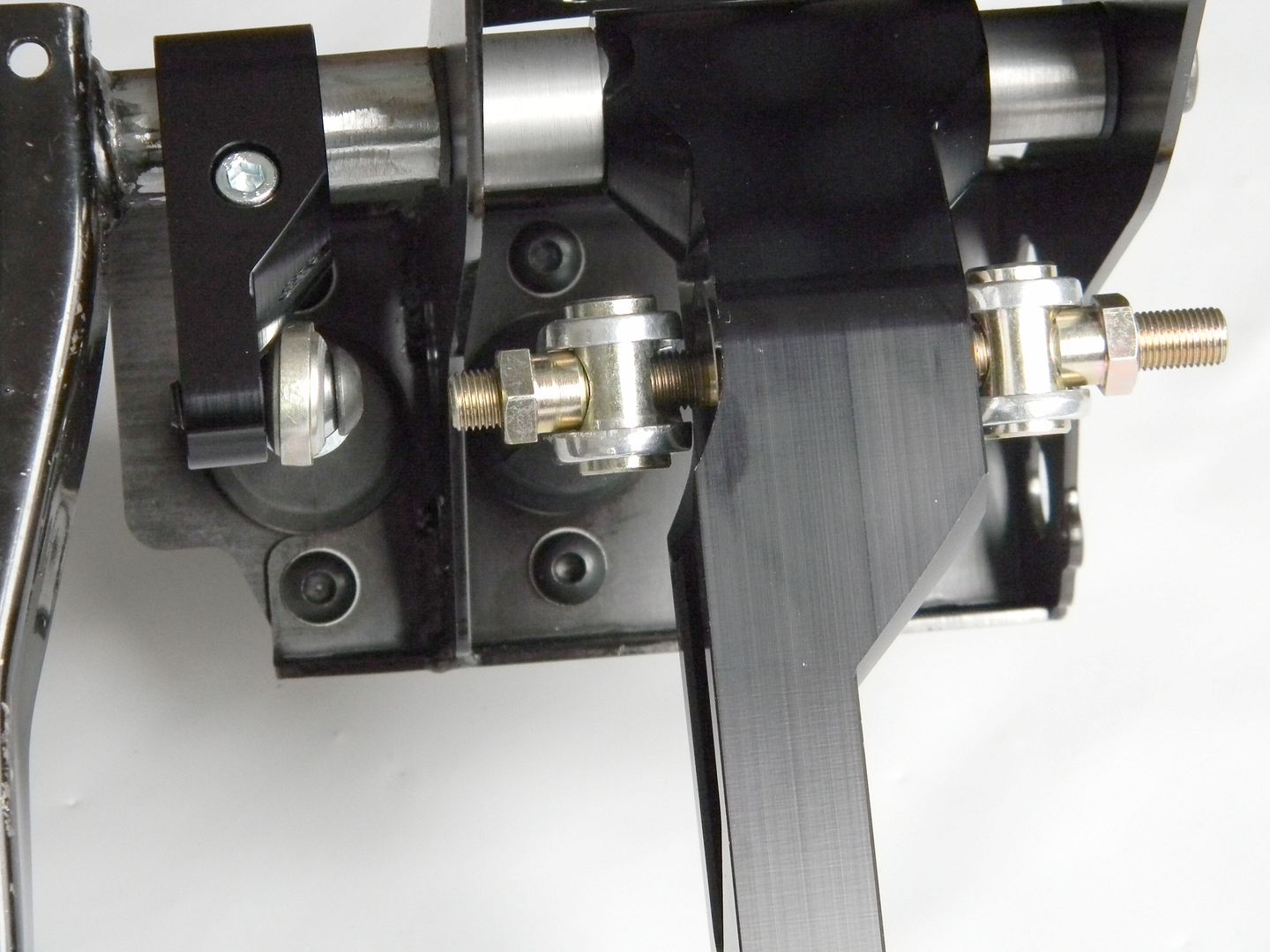

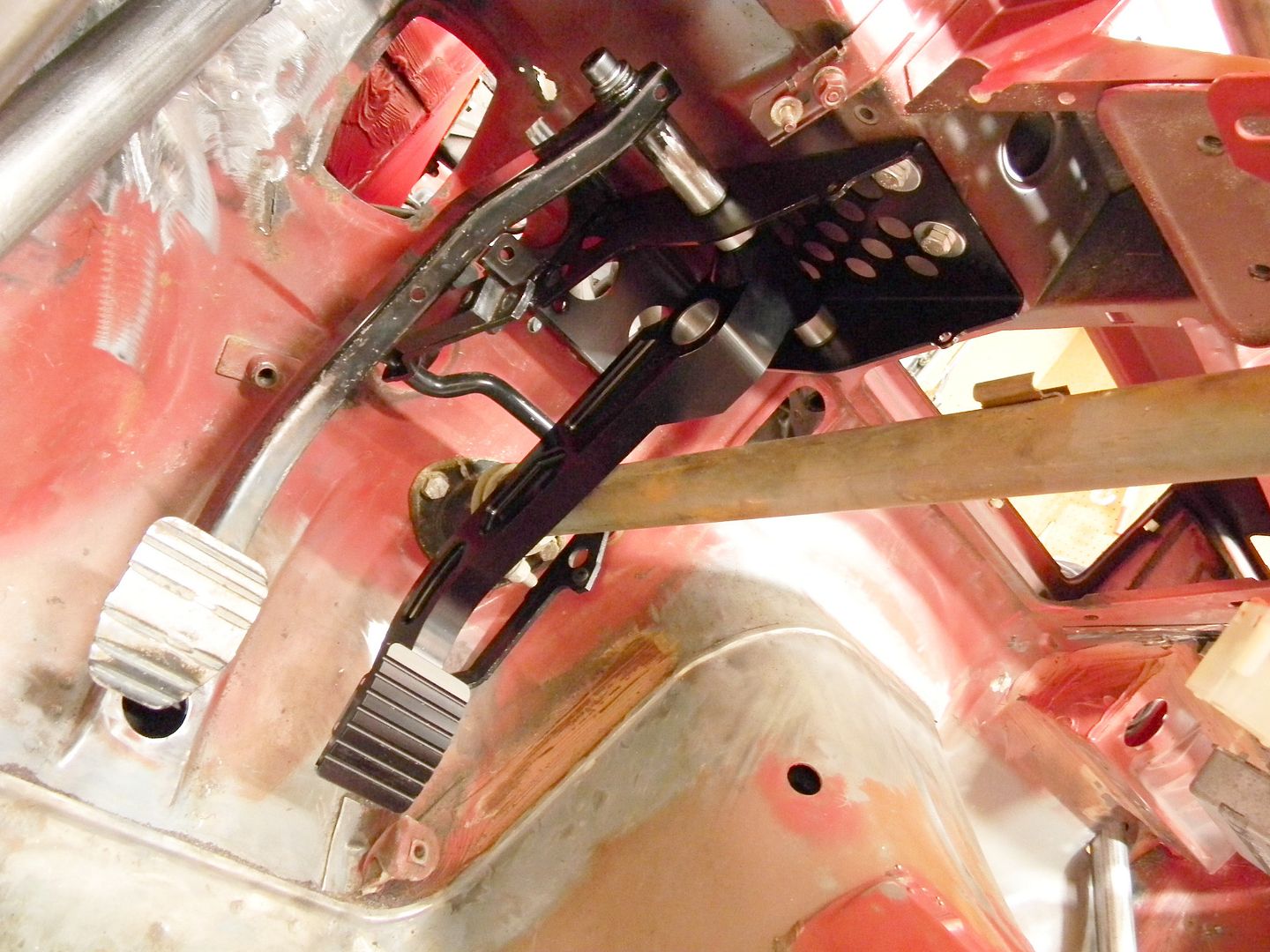

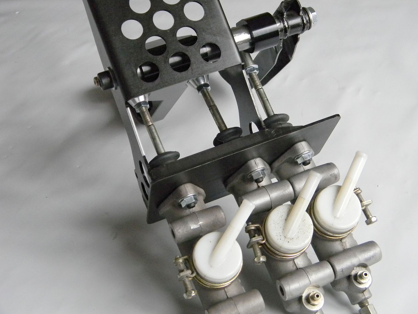

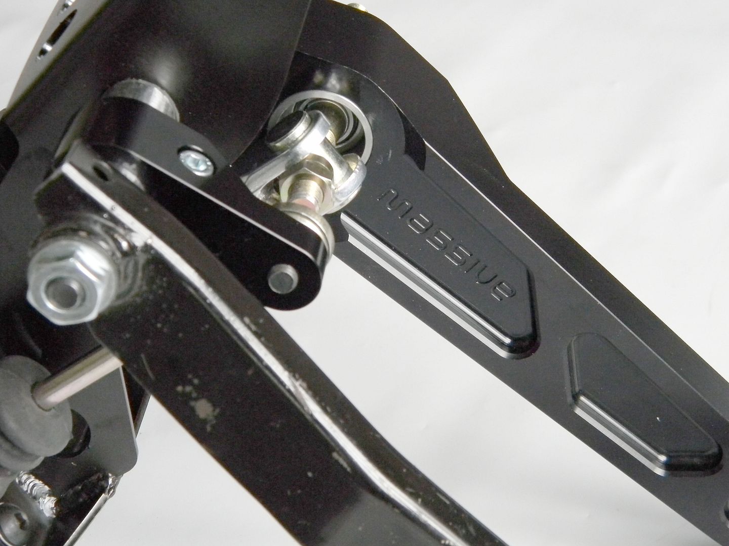

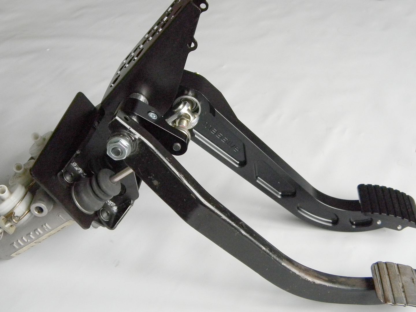

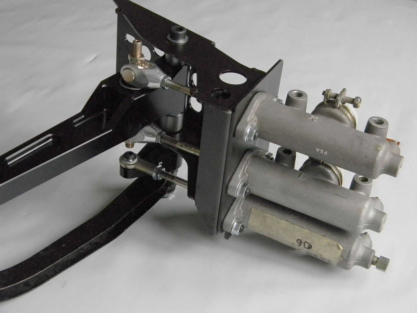

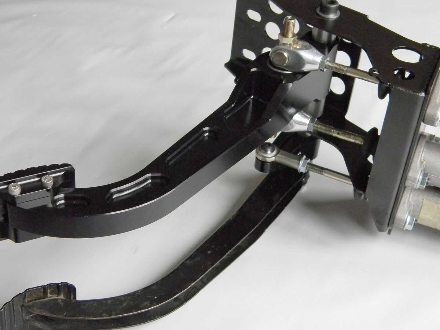

                            • Massive Lee
                              • Sep 2006
                              • 6785
                              DTM repro for LHD e30. Fits in stock location.
                              Requires a balance bar wit 1" spherical joint. 2-1/2" MC spacing. Works with most Tilton, AP or Wilwood masters.
                              3 years of development ;-)
                              For the gaz pedal, a DTM repro unit can also be used
                              massivebrakes.com
