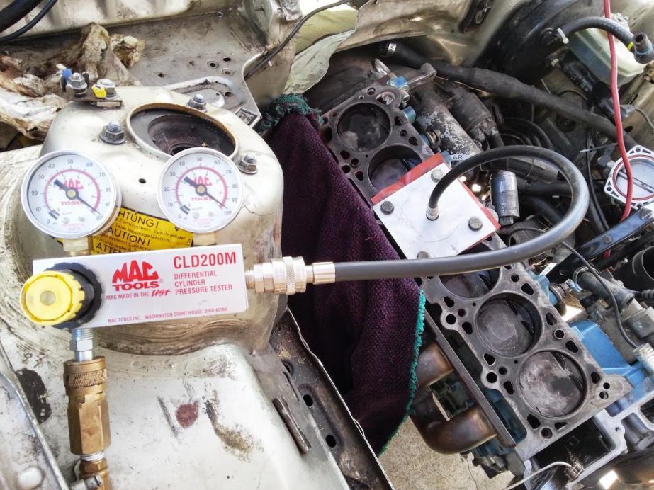

                        IF going beyond stock 6,000 rev limit = over run then yes, it was ran with a turner motorsports chip to 7,000rpm for about 10 hours; I am 100% sure the raised rev limit contributed to the valve spring retainer failing.
                        We leaked down the short block cylinders individually before installing the built head; each cylinder was within 1.5% with MAC leak down tester.
                        It is easy to build a fixture to test for this; you can use it on each cylinder on head or block
                        Oil pumps on these engines rarely fail unless the nut backs off; ours was welded on.
                        The pickup falling apart due to vibration was something new to me
                        A dropped valve from broken retainer caused the carnage; it simply wore out.
                        All the bottom end bearings were still alive amazingly even with the destroyed oil pickup
