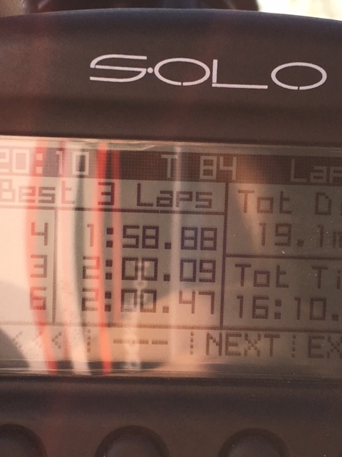

                Well as a reference I was putting in consistent 1:59s all day yesterday and finally dipped into a 158.8 with my s54 car. Car pretty much has everything done to it under sun at this point. I think my limiting factor is wheel/tire size as I did this on 225/45 nt01s. 245/40s here I come lol
                  Congrats man! That's awesome. A wider tire will definitely make a difference. I'm shooting for a 2:05 with the M20. It's a bit optimistic but I think the temps will be more agreeable in December. You should come out.
