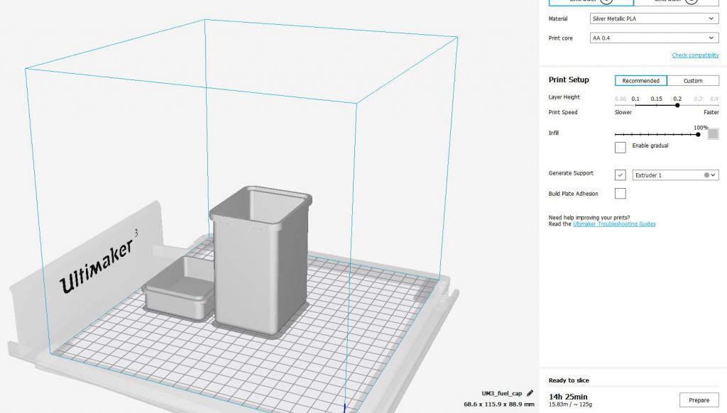

                I did a quick 3D print design and printed out a proof of concept piece using a nylon filament.
                Unfortunately the nylon dissolves in gas (tested it over a few days), and I don't have access to any more "hardcore" filaments with this particular printer.
                There was also the question of having to find a way to epoxy some brass fittings etc.
                Meanwhile I ordered the Ford unit, so more to follow when I receive it!
