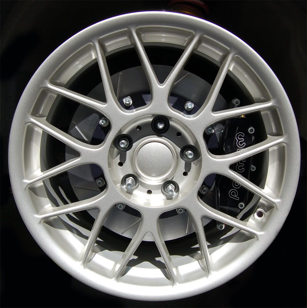

          We tested Paintpro's 5 x 120mm et20 version with Massive's 332mm x 32mm and thick SL6R calipers as well as the narrower SL6R14. The outcome is very positive. The 4 x 100mm wheel should fit exactly the same. That wheel was really designed for BBK clearance as I remember seeing the various designs until this final version and consulted with Paintpro many times over the past year.
          Pictures start at post# 296

            • 395
            #545
            That last pic...
            Droooooolllllllll-
            Dammit Lee, I keep trying to convince myself that stock brakes are good enough for now...

              #546
              Hey. That's what the Spec_e30 guys also say. Until the rules change... one day.
              The kit pictured above is 332mm x 32mm, and in conjunction with the rear 310mm x 32mm, I was told by racers it is even too much brake for most tracks. But, they do allow to keep with the big cars (rear Porsche GT3).

                Sexy stuff, Lee! That sure is a good looking ultimate setup.
