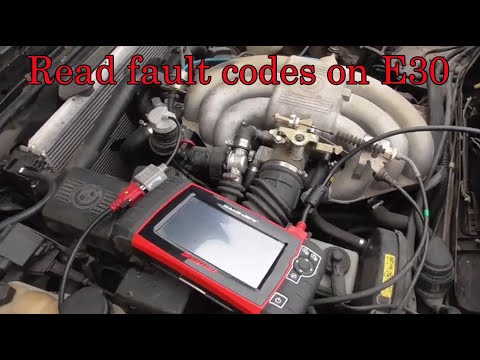

      Yea I was planning on checking that soon. My understanding is you can use the e30 specific code readers to get a 4 digit code, and if someone is only a short drive away I figured it was worth a shot.
      • 82eye
        • Jan 2009
        • 2109
        you might be able to find an 80's snap on mt2500 or an updated 90's snap on solus that plugs into the diagnostic port in the engine bay and will give codes if the car is running. they require a connector and specific software which was separate from the code reader. they're not cheap even used but do pop up on ebay. the readers are useless without the bmw software and connector.
        edit : maybe you can find someone who has it. i've been looking local or online for a deal since i've seen it lol.
        if i find one cheap enough i'm gonna buy it.

          I moved back east a year ago, so I really can't help, but I have a Baum CS1000 that just reads codes and spits out a number that you lookup in a booklet. I also have Baum CS2000, which provides descriptions of the codes and can read the live data stream from your ECU. I REALLY like the CS2000 for how well it functions and that it's a cool old school tool.
          If you get either, make sure you have the correct coding cartridge for BMWs. It's a little pricy for the tool, but it's also nice to have for future diagnostics.
