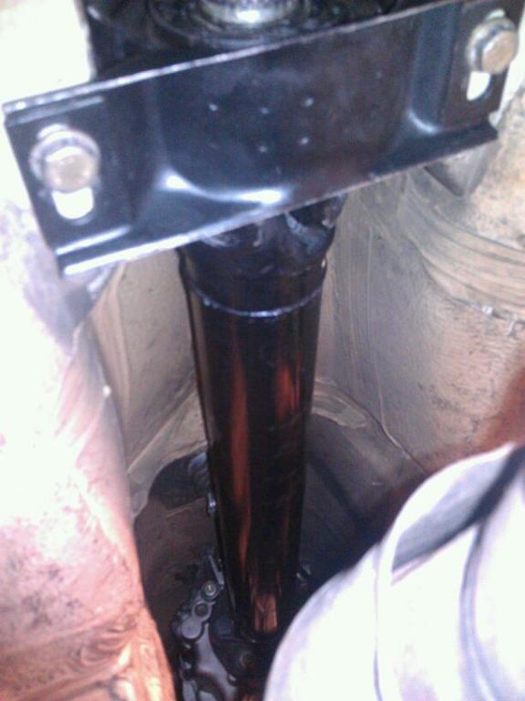

    Originally posted by turge
    So something like this?
    [ATTACH]59100[/ATTACH]
    Sent from my HTC ThunderBolt using Tapatalk 2
    looks a bitt too centered. i would try and push forward a little more. i usally try and match outer ring of the CSB to the metal inside. just try to push it forward as much as you can.
    as long as it isnt in the relaxed position, it should b fine. other wise your guibo will begin to tear away.
    you put in a new guibo with the new CSB correct?

      Yup new everything.
        Yup new everything.
        yeah. then just push it as far forward as you can. everything should b fine.

              #35421
              Better?
                Better?
                [ATTACH]59101[/ATTACH]
                perfect
