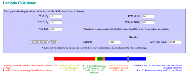

        Originally posted by R3Z3N
        Check this out as it might be able to help you. Scroll down to find the smog calc:
        Saw this on autoblog:
        thanks. here what i got
        Originally posted by QUKBMER
        Becareful......3rd time failing and its off to the state referee staion my friend. Be careful :(
        well now im freaking out.
