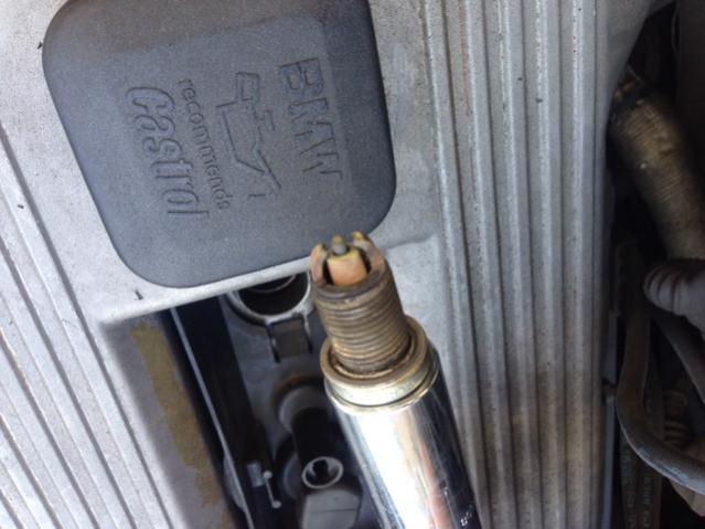

Wrong plugs... but that won't solve your problem unfortunately. Mike has laid it out right. It's either fuel or spark and Edwin could be on the right track. Check to see if the plugs spark when you crank the engine. If you do then check fuel pressure at the regulator.
Cheers,
Jim
I was talking to mark in PM earlier, I checked for spark and nothing, but I'm also not even getting the engine to turnover. I removed the small hose off the FPR, turned ignition to "ON" checked and there was no fuel. I couldn't smell fuel on the plugs either.
