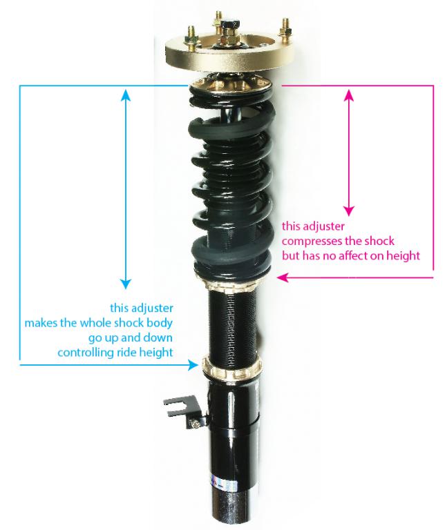

                      this is an example of preload adjustment on a bc front coil:
                      the rear does not have a second sleeve to control the compression of the rear so there is no preload on our oprhaned spring set up.
                      what coilovers are you running?
                      when you shorten the shock length you are losing shock travel. less travel means less comfort in it's simplest form.
