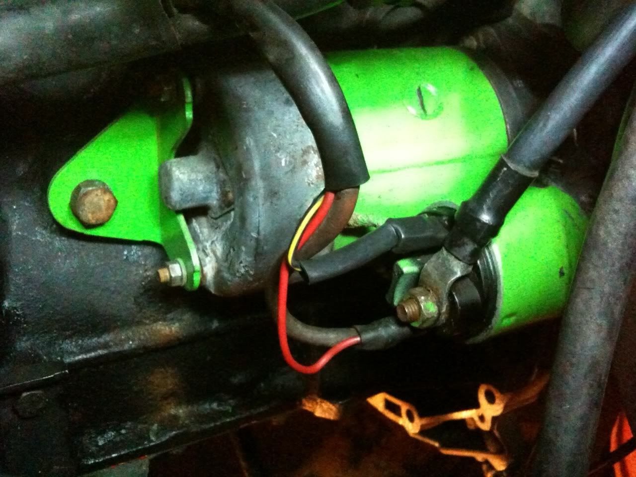

          Ok total noob mistake where does this hook up to?
          • golde30
            • 11464
            #33905
            Haven't dealt with an m20 wire harness in a looong time, but looks like starter + wire.
                  here is a pic of an eta one. it's similar. make it goes on the outside stud on the starter solenoid. not the one with the copper ground to the starter. the wire that you are holding goes on to the stud, then the other wire that is the same size goes on the same stud. then a 13mm thin nut.
                    Damn so I did have it on right. Must have a short some where or something not hooked up right. Hooked it up there tried to start it and power shut off and battery terminal started to smoke.

                      #33910
                      you got something way wrong there if the terminal is smoking, you grounded it.

                        Is it possible for the starter wires to touch and therfore cause a short or what not? Or if I didn't plug the sensors in the right socket, it would cause the same thing
