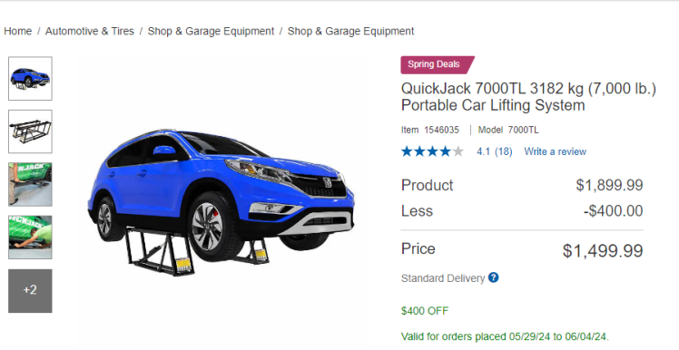

    Costco Canada QuickJack 7000TL Deal
    Last year this went on sale at this price, but I wasn't sure if that was a regular/yearly thing.
    I held out long enough and surprisingly the same deal is on again this year - only from today until June 4, so if you're looking for a quickjack or similar, pull the trigger while you can.
    The same model is on sale at home depot for $2800, or amazon for $2230 so this seems like a steal, especially with the Costco warranty.
    Click image for larger version  Name:	image.png Views:	0 Size:	144.6 KB ID:	10121146
    https://www.costco.ca/quickjack-7000...100757488.html
    7000 lb rating
    20.5" height travel (so maximum height is basically 21.5" with included 2" block, 22.5" with included 3" block, 24.5 with both stacked, or up to 27" with the optional truck adapters. But basically comes down to how low the car is.)
    3.5" minimum (with the rubber block, its actually 4" - may be an issue with slammed cars, but I'm sure some wood scraps would take care of this.)
    1797 mm / 70.75" length when flat (ie. how much space needs to clear between wheels. E30 wheelbase is 2570 mm / 101.2 in, and my much stubbier R56 fits with the "5000TL" version, which is only .75" shorter.)
