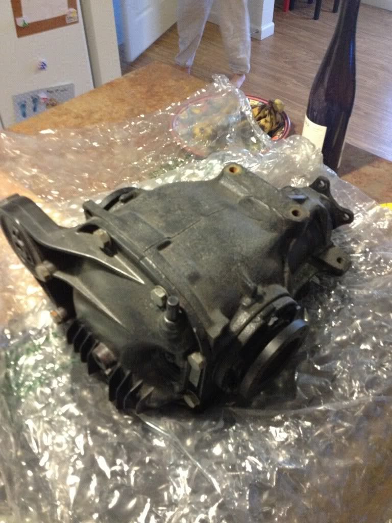

                    This is a nice way to start your Monday!
