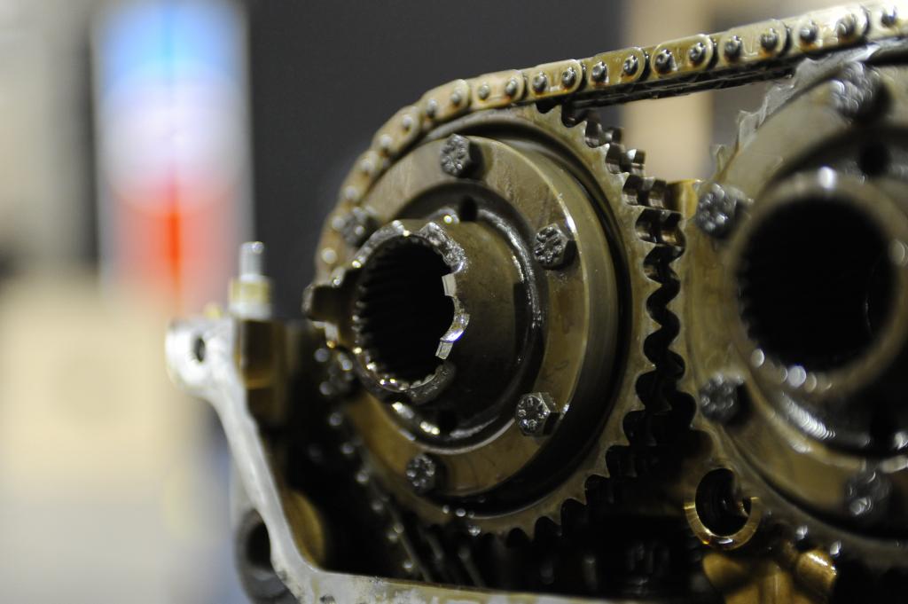

                        Seen what you're talking about a few times, most people will break one pin like the one above and never know it. This is an issue on all S54 I don't believe they ever changed anything regarding the vanos oil pump drive. Most of the time this happens when people start the car up in the morning dead cold and just drive off. The vanos system runs at about 100 bar, to do so it uses fairly small ports to keep the pressure high, the pins that we are talking about are lubed by these small ports as well, one on each side of each pin so in the dead cold morning with dead cold oil the pins don't have sufficient impact isolation so with the motor speeding up and slowing down it the pins are basically getting hammered back and forth. And most S54 sound like shit warming up so you never think anything of it.

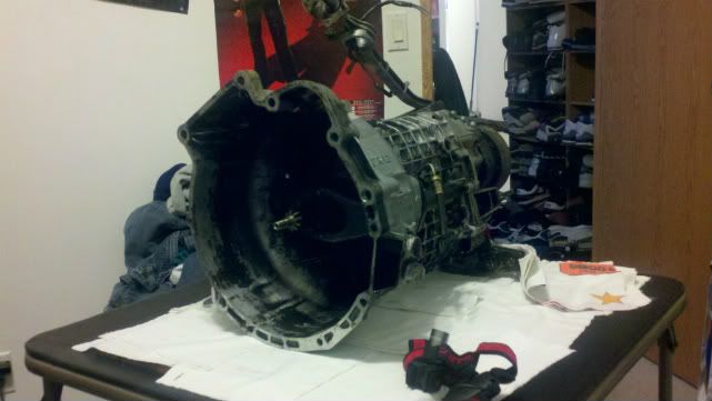

                          You won't need to. Most of the weight is from the ass end of the trans, so it will keep itself supported.
                          Was completely covered in oil, but I did this with a garden hose & Super Clean. Thanks Austin

                            You have a tranny in your room.

                                The s54 gear is weird usually you get a code but not always. A while back I found these
