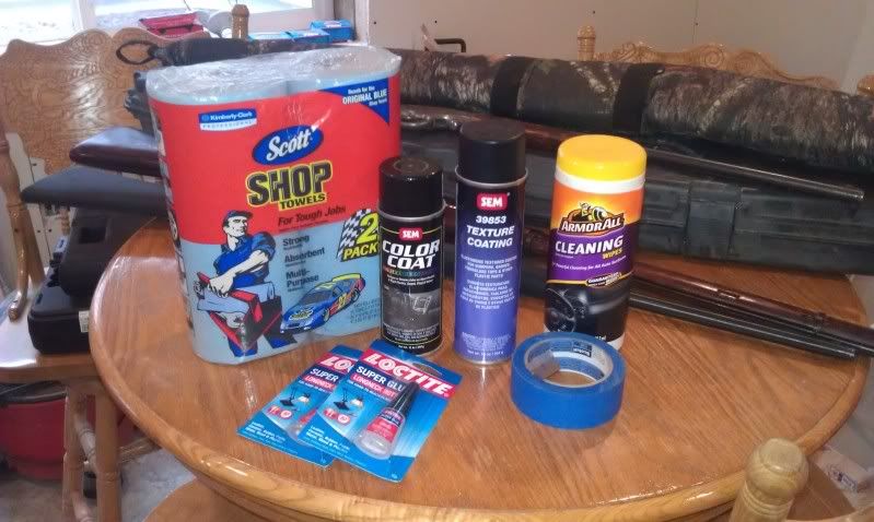

    Next long post to the rescue!!!! Finally got a chance to refinish the dash (not as well as i had hoped) Followed the entire process for if someone wants to try themselves (can be done much better than i did, but it was my first try...o well.)
    First you must start off with your supplies, I have the majority of them pictured here. (dont mind the guns lol...)
    Shop towels
    Super glue
    Some kind of cleaner (i used armour all wipes)
    SEM Texture
    SEM Paint (i used Landau black)
    Painters tape
    Razor blades
    Rubbing alcohol (used to clean of the greasy residue of the wipes for final prep)
    Baking Soda
    Painting mask/respirator
    How the dash started.
