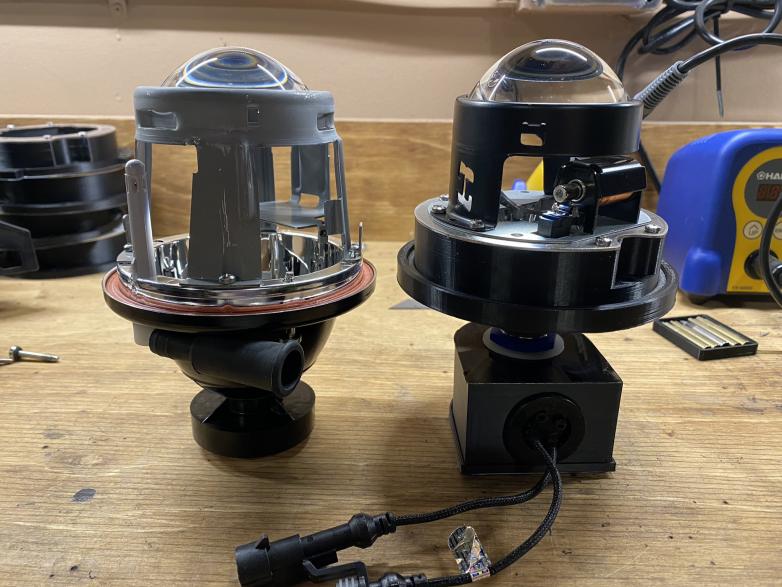

      Originally posted by gilber33
      Got a Bosch Smiley adapter mocked up! You're also seeing the new bulb "box" that mounts on the back of the projector to seal in the bulb opening on the back of the projector housing. The wires exit out of the side of the box instead of straight out to make things a little tidier inside the engine bay and to make sure the projectors still fit behind the headlight covers if you have them.
      Click image for larger version Name:	IMG_5703.jpg Views:	0 Size:	46.6 KB ID:	10046817
      Click image for larger version Name:	IMG_5701.jpg Views:	0 Size:	59.4 KB ID:	10046818
      Click image for larger version Name:	IMG_5702.jpg Views:	0 Size:	58.1 KB ID:	10046819
      Click image for larger version Name:	IMG_5700.jpg Views:	0 Size:	66.4 KB ID:	10046820
      Very excited for this. Following closely, can’t wait to put an order in.

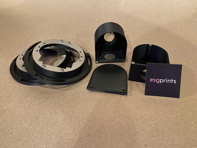

            Originally posted by KI4UJO
            Also in for the sealed box! My e30 lives outside and gets driven in all weather, it would be a nice addition.

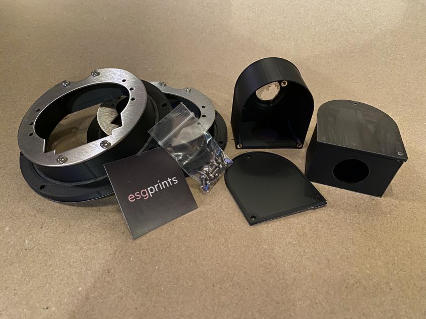

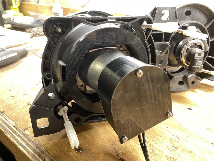

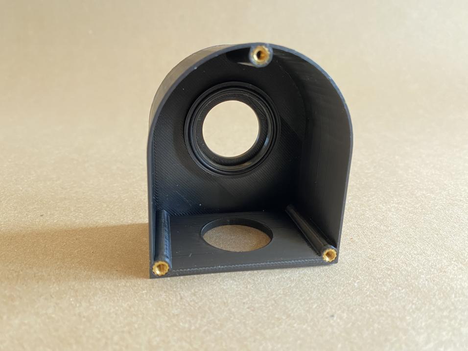

            Awesome! I know it doesn't provide as "clean" or simple of a look, but I think this is one area where function takes precedence over form.
            The Bulb Box seals against the mounting nut on the bucket, and then the mounting donut inside has a groove with an o-ring fitted that seals on the bottom side of the bulb retainer threads. Then the wires for the bulb exit out the bottom (or side if you wish depending on how you orientate it) so when your looking at the projector from inside the engine bay, you'll only see the clean face of the lid. for extra protection, you could run a small bead of sealant along the lip of the bucket before you put the lid on.
            As always, all threaded holes are heat-set threaded inserts with M3 stainless steel screws included.

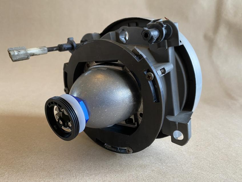

              Oh, and Bosch Smiley Adapters are live on the website. By far the hardest adapter to design, but definitely the easiest to retrofit.

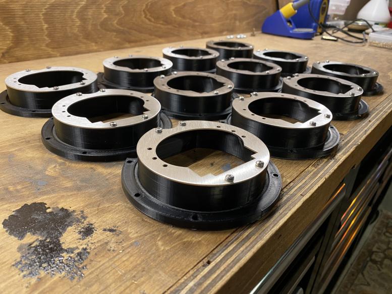

                  Here's some Depo adapters being assembled.

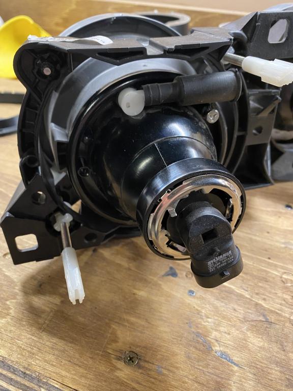

                    A retrofit in a few easy steps! Remove the stock projector. Trim the housing. Assemble the new projector. Install!
