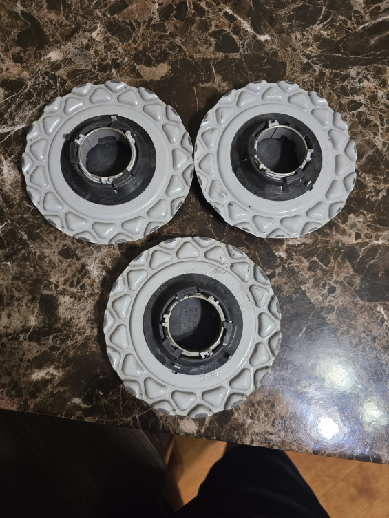

    Centercaps honeycomb off 325is 1988
    I have seen these go for high prices. Wanted to see what they are worth here to you guys. Only have the 3
    Click image for larger version  Name:	20241101_192644.jpg Views:	0 Size:	228.5 KB ID:	10129267 Click image for larger version  Name:	20241101_192635.jpg Views:	0 Size:	254.5 KB ID:	10129268

    The ones you have in those photos look to be the cheap plastic replica versions based on how the back side of the waffle appears and would be worth very little $$ if plastic waffle, but I could be wrong.
    If they are indeed metal, they’re worth $50ish a pop, as you can still get them new.
    The super expensive ones are the NLA 171mm caps for 15” weaves. Yours are 151mm caps for 14” weaves.
    36132225622
    Hope that helps-

      AWDBOB how do you know that these for the 14" and not the 15" basketweaves?
        I think the pattern is the giveaway... someone told me that 15 inch has more of a pentagon shape and these 14inch are more triangle
        • Panici
          • Dec 2009
          • 2329

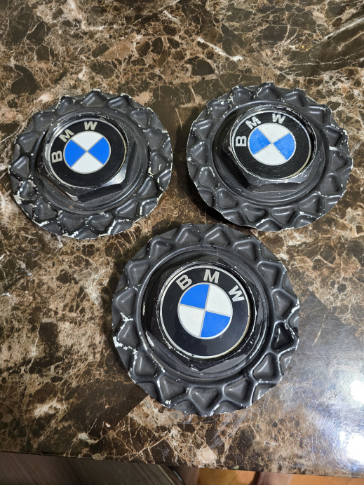

          Nailed it. Look for triangles on the 14" caps.
          Here's some pictures for reference:
