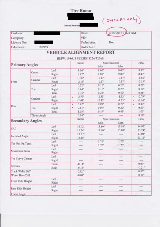

      #107
      Details of alignment situation in pic. Can’t wait to get this resolved and get a good looking Garagistic unit back in place!

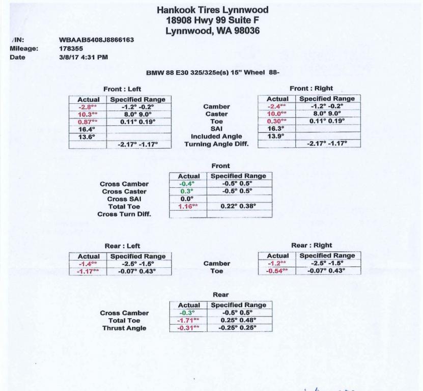

        To you and thedentonmare, I've got major alignment issues with my subframe as well.
        Camber is perfect as far as I'm concerned but toe is wildly out on both sides and that is at maximum adjustment.
        I contacted Garagistic last year when I installed the subframe (hardly ever drive my e30 anymore because I have a 335d daily,i still haven't sorted my subframe) and they would not take responsibility for it because I did not provide an alignment sheet from before install. I have a 5 lug conversion and the (reinforced) 318ti trailing arms I have are incredibly expensive new (they might even be NLA), so it is not feasible for me to replace them.
        I actually have a freshly powder coated stock subframe ready to go in with the Garagistic 12mm raised subframe bushings to reduce the camber, and I'm leaving toe alone.
        The adjustment mechanism of eccentric bolts is just not practical for street car purposes especially given the fact that you cannot fit standard tools within the space where the bolts live. This means you can't adjust while the subframe is installed, and you certainly can't torque them while installed either.
        I've attached an image of the alignment sheet right after install as well.

          I spoke with Garagistic who suspects the issue is with the drivers side trailing arm. They’re welding up and powder coating a new part and sending to my installer.
          So far I’m pleased with the response, but it sucks to have the car nearly back together and have this happen.
          If it turns out to be the subframe after all ( I purchased all new subframe and trailing arms from them). I will be heart broken and frustrated and probably be forced to get another product elsewhere! Hopefully that doesn’t happen and the trailing arm replacement solves the issue.

              Latest update is that we experienced further delays getting the replacement control arm due to a blemish on powder coating.
              I'm pleased that Garagistic cares enough about sending out a quality product that they refused the powder coating and sent it back to their partner... but obviously frustrated that this has turned into a multi-week saga story with my car laid up at the shop.
              ETA for the shipment is now Monday 6/25 to land at the shop, at which point we'll try reinstall and alignment. If we still have issues, then will have to assume that the subframe is the issue and I will ugly cry in my closet at the prospect of further delays.
              More to come..

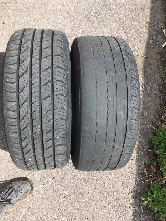

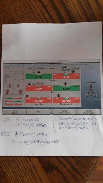

                      Here are our numbers. We just had the rear checked when we found the trashed tires.

                        Picked the car back up this morning, and can report success.
                        The guys at the shop were actually surprised that it came down to a faulty trailing arm as the issue. Swapped out the problematic drivers side, and were able to adjust it into alignment with the right side.
                        I'll try and post #'s later on.
                        Thanks again to Garagistic for making this right, now to get all my $$$ back from core refunds and the other trailing arm that I paid for to correct the issue.
                        I've yet to do any extensive driving, but so far I'm happy at the end of this long journey.
