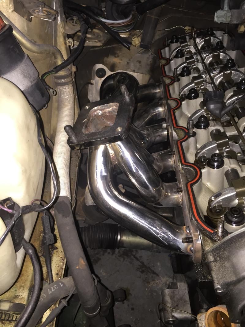

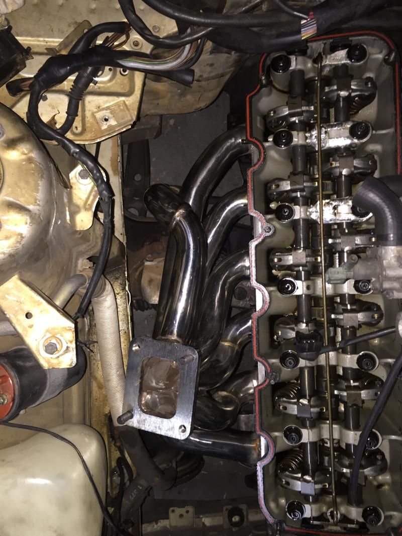

          Some test fitting today, needs minor tweaking but over all plenty of room for a 3" DP or 4" if you want. Wastegate fitting spot on.
          I'm trying to locate an ix locally to take some measurements to verify fitment. But if anyone wants to take a few and share that would be great.
          It deff looks like it will fit the ix judging by the clearance from the shock tower, but need 100% verification.

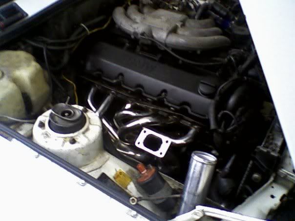

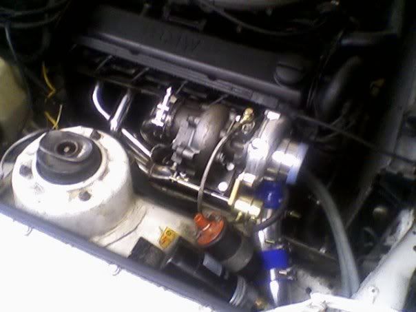

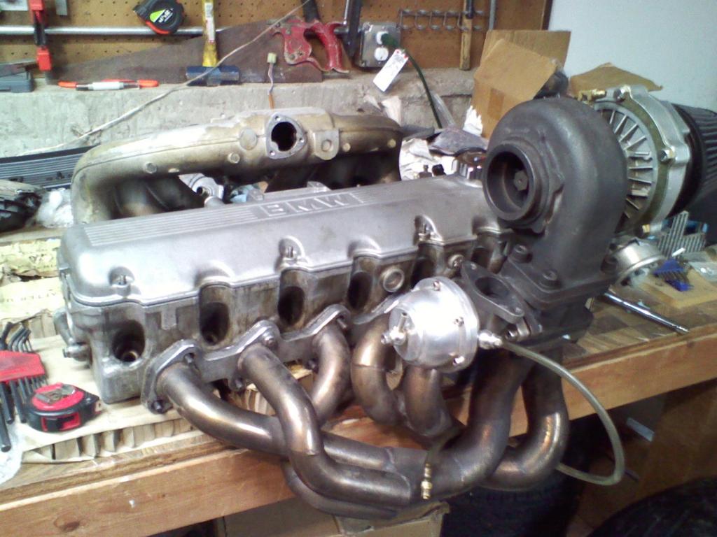

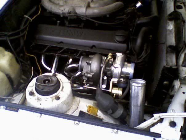

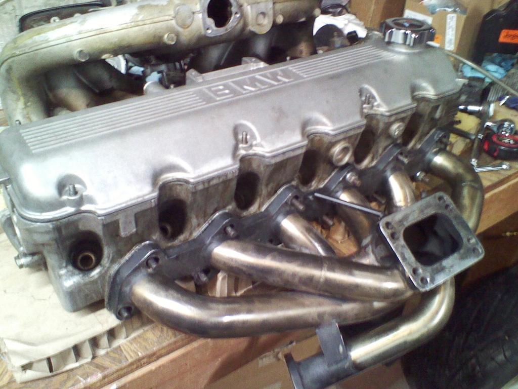

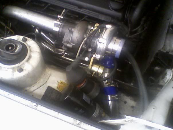

                Originally posted by Northern
                My Dan Pinder group buy manifold hit the original engine mount arm on my iX, and the WG provision that was added to fit a RWD car interfered slightly forward of the strut tower on the iX
                Edit: I should mention that the Dan Pinder manifolds are what the CXracing/Ebay manifolds are copies of, so they don't fit the iX either.
                Note sure that is true. I will be finding out on my iX turbo build in the next few months. I have both manifolds, see uploaded pictures of both cx style manifold attached to a head, but I plan to use the Dan Pinder style due to better fit and design. This is also the style kamotors is selling with his turbo kits.
                Either way, the 325ix turbo from puerto rico used the ebay manifold and it seems to clear just fine. User AlpinaB3 on r3v. Notice the strut towers in the below photos.
                And his thread on here
