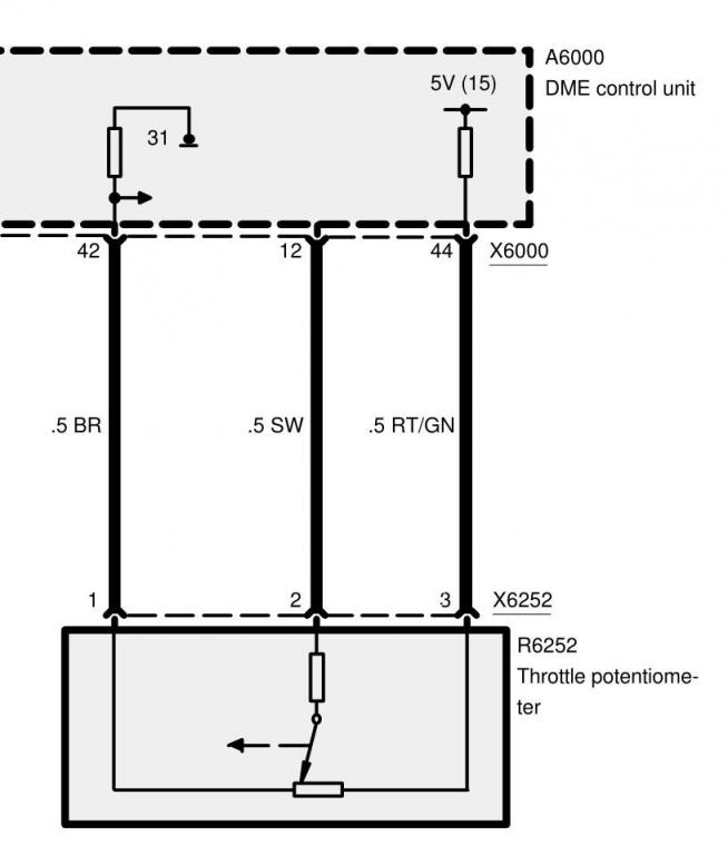

            You don't need this. Just swap the pins in the stock connector and plug it in (IIRC, signal/ground are reversed). You could even buy the parts yourself on digikey/mouser and make one for like $10, but still. Just swap the pins.

              Info on the TPS wiring:
              https://www.r3vlimited.com/board/for...95#post9917595

                    Lol. make your own. I posted a link above with all the info you need.

                      For some reason unknown to me, the MS2PNP boxes that are currently available now do not like this. They need the wires swapped (1 and 2) - see attached, On the E36 pin 2 is "signal" and Pin 1 is Ground. On the E30 (and therefore the MS2) it expects pin 1 to be the "signal" and pin 2 goes to ground. Pin 3 is V-ref on the E36 and on the MS2.
                      When I learned this, I switched to making them all with the wires swapped, and they work on the DIY MS2s in my cars as well. All the ones I make now swap Pin 1 and Pin 2. Pin 3 is always direct.
                      If you use a PNP MS2, you can repin the stock wiring and plug it right in also. However, this puts tension on the wiring since the E36 TPS faces backwards compared to the E30 TPS, plus it’s pretty hard to plug it in with the TPS installed.
