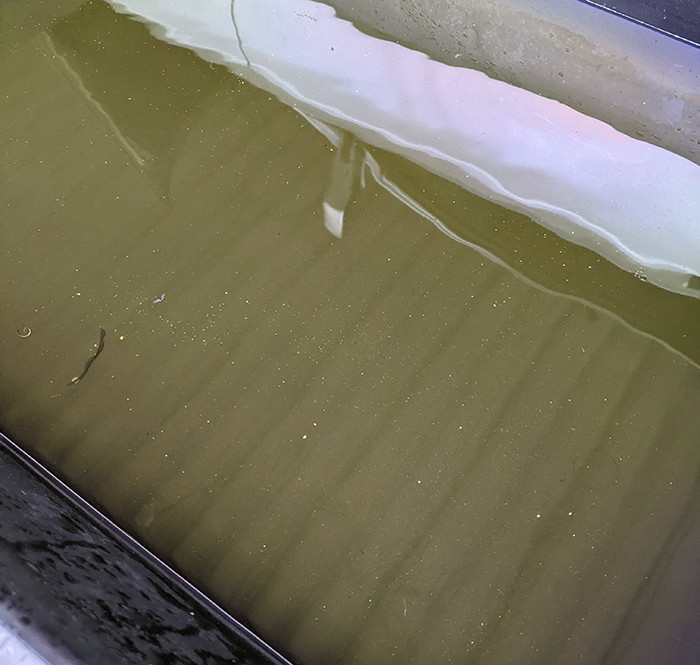

          As a matter of fact, this has been appearing for a long time, as first pointed out last March.
          Originally posted by Chilezen
          Click image for larger version  Name:	PXL_20220320_011430862.jpg Views:	145 Size:	98.5 KB ID:	10050691
          One extra important bit of information: Every time I drain the coolant, there's always debris. This is metal flakes mostly, and some tan bits of, something. Yes, there appears to be a thread shaving on the left. And a bit of black gasket stuff (?) next to it. This is exclusively drained from the radiator, and I cleaned the pan prior to filling.
          ​The problem has probably not gotten worse because of how frequently I drain the gawddaymn coolant. I'm only focusing on it now because there aren't bigger problems to address anymore (a small win! lol)
          So yeah, despite multiple flushes, the early batch of tap water may still be causing this issue. Super flushing the rad alone might be enough. With gasoline, you say? I'll have to look that up. I've used it to clean parts before, but I never expected it to take care of calcium buildup.

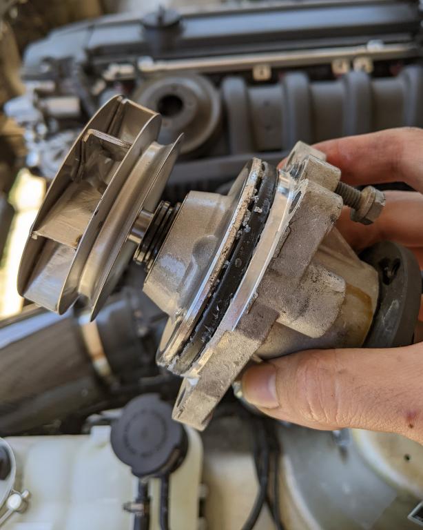

          I checked the rest of this thread and saw another mention of debris:
          I have replaced the factory water pump with a Stewart pump. I do like the design of the Stewart, the way it directs the water up. Pretty smart.
          Upon inspecting the factory pump, I found..... nothing of interest. It looked fine. No rubbing or scars on the impellers. Spun freely, quietly.
          Click image for larger version Name:	PXL_20220501_211758014.jpg Views:	0 Size:	60.8 KB ID:	10055202
          It had a little bit of "grit" stuck in with the lube around the O-ring, which I thought was odd, but I've already been seeing debris come out in the coolant, so it's no surprise to see it there.
