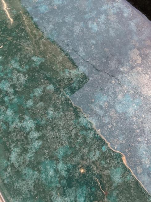

                      When I drained the coolant for this job, I found this:
                      It's very cloudy. What the hell?

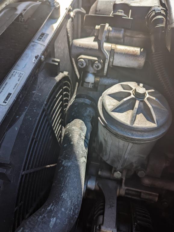

                      The upper radiator hose burst on my way home. On the right side there, next to the oil filter housing. Nothing could have been rubbing it, and it's a "new" hose (less than a year old). Rein brand.
                      I had to walk a mile each way to go buy a new hose, which didn't even fit correctly (my only option was a Gates brand that was too short, but it BARELY fit. I had no choice at the time, and thankfully, it held!)
                      I just added more distilled water because I knew I would be replacing the hose again soon.

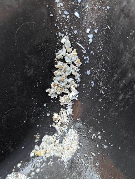

                        Anyway I'm seeing a lot more of this crap:
                        I have to use a pick to unclog it, and pour more water in to flush it.
                        There's a lot more of it this time, probably because I actually put in the effort to unclog it this time.

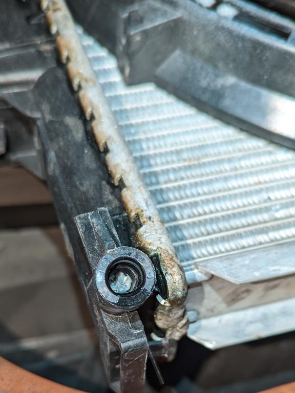

                        Here's how it looks sans-water.
                        WHAT IS THIS AND WHY IS IT HERE??

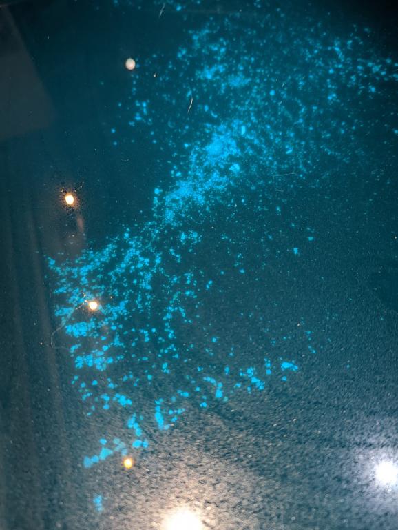

                        So I decided to, before replacing the pump, to run a "radiator flush" to help clean out... whatever could be stuck in there.
                        I used a "Blue Devil's" brand, poured it in with more distilled water, bled the system, drove around, and drained it.
                        Less crap came out, which is good. I feel like there's more in there still.
                        Please advise
                        Any ideas on the cause, and how to prevent it, and why the car still has cooling issues...

                          Additives usually cause headaches. Id assume it was the blue devils if you google what it does to the internal bits. .

                            When did you put that blue junk in?

                              Well, it's a chemical flush, so, I added it about an hour or two before draining it. I added it to help remove the sediment. The flush definitely isn't responsible for causing that.

                                Your car is making meth.
                                This looks like the reaction when the incorrect water is used. I bought my 86 325 and the head / thermostat housing was chock full of that stuff. It is aluminum corrosion.
                                I first experienced this by using the wrong water in my Rx7 and it cost me an engine. Slowly the radiator plugged up eventually overheating the car. I could literally feel a cool spot in the radiator where the tubes were clogged. You may want to see if a shop will flush your radiator and verify its not clogged.
                                How well grounded is the engine?
