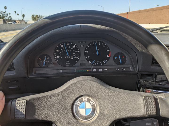

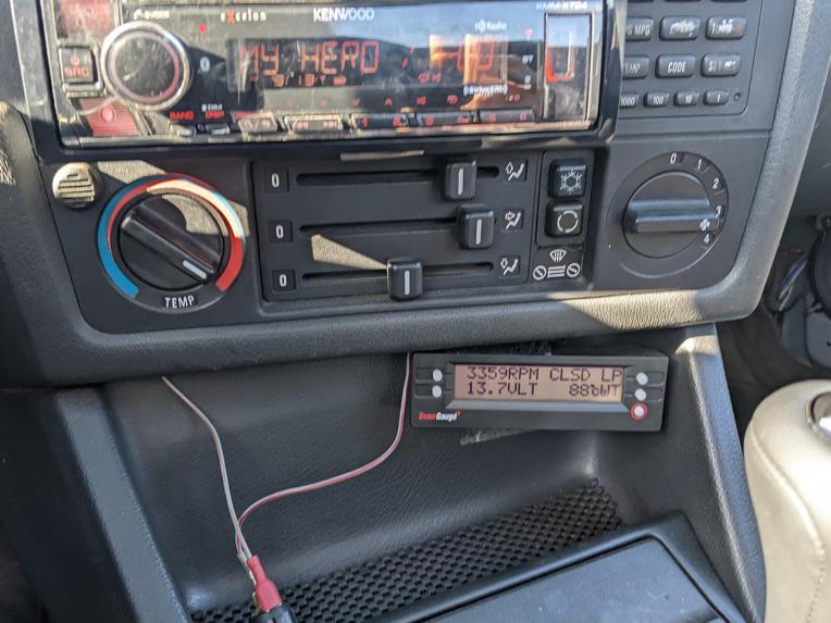

                I have pics,
                One my way to work after the temp stabilizes:

                I get my exact temp reading from the ECU with an OBD2 scanner: (the dangling wire is my manual fan switch)

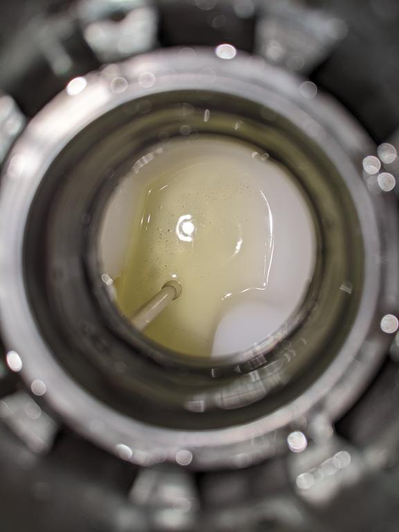

                The new reservoir looks like the old one: covered in coolant.

                I have also noticed some debris in the res, and when I've drained the radiator. Small specs of.. stuff.

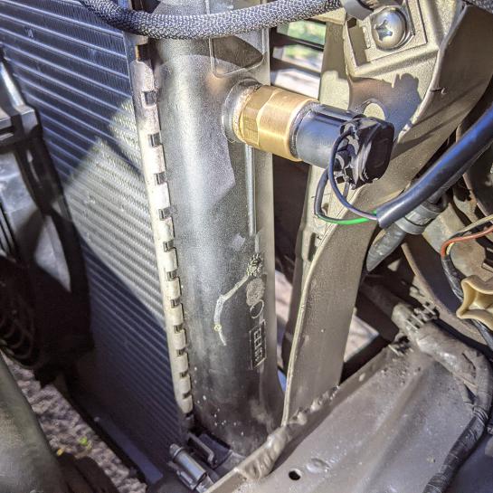

                  Forgot to mention, there's a leak from the rad sensor too:

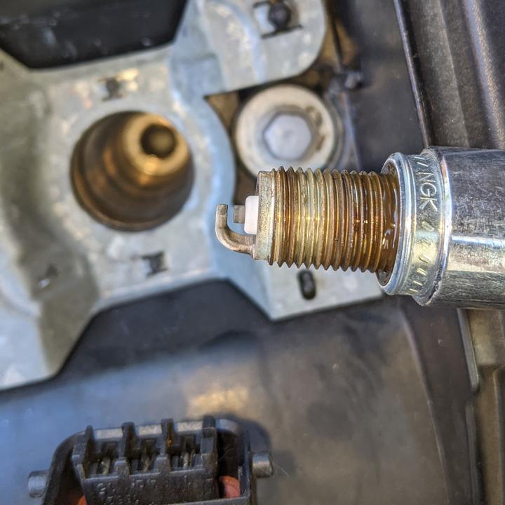

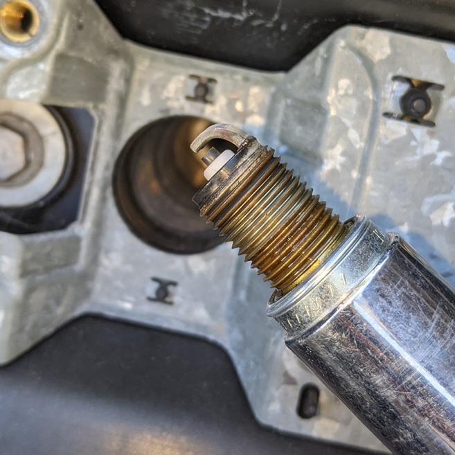

                    For fun, here are the spark plugs. They look okay for only running about a thousand miles?
                    Only 4 pics but the last two look the same.
                    My exhaust pipes are caked with soot.
                    I'd love to install a wideband in the future.

                      Interesting that your exhaust pipes are "caked with soot" but your plugs look really clean...I'd think that the plugs would be much darker if the car was running rich.
