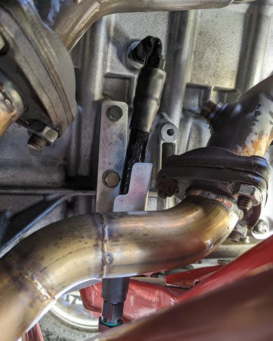

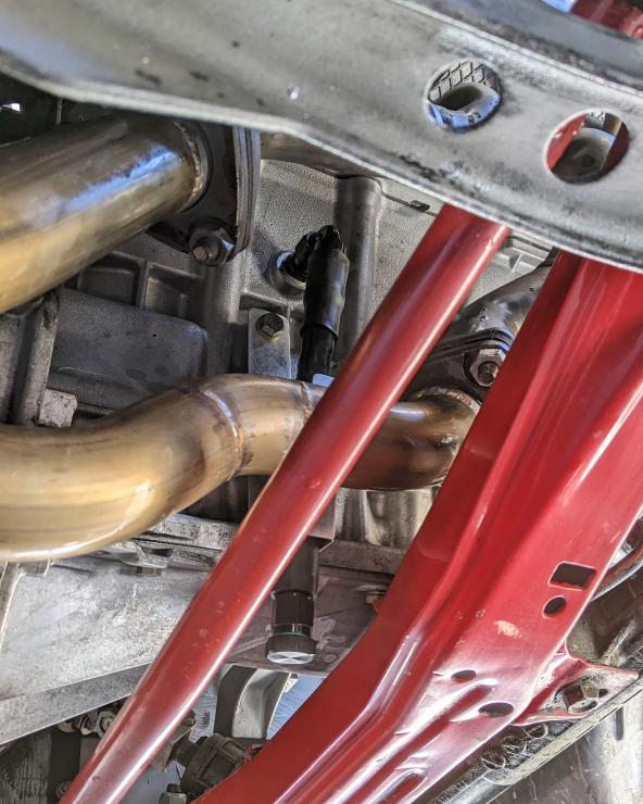

    I've also installed an engine-block-drain-hose, the idea of which I got from Charlie. Sh3rpak!ng
    Click image for larger version  Name:	PXL_20220501_202431752.jpg Views:	0 Size:	73.4 KB ID:	10055203 Click image for larger version  Name:	PXL_20220501_202606356.jpg Views:	0 Size:	64.7 KB ID:	10055204
    Around the hose, bolted to the block, is an aluminum heat shield I designed. It holds the hose in place, away from the exhaust. I should have gotten a better picture of it by itself. Hopefully you get the idea.
    But anyway so far it's holding up, no leaks that I've seen yet.

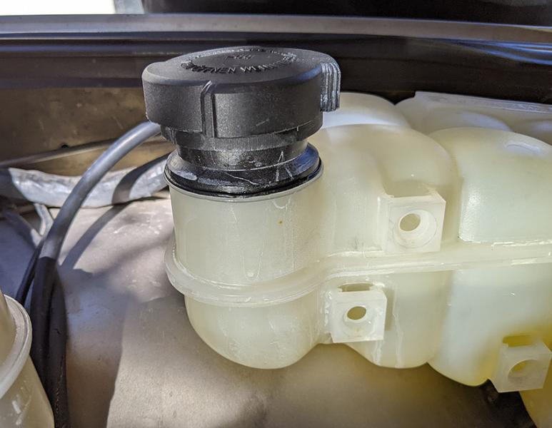

    The coolant does still leak from the reservoir cap, and from underneath the rear of the head, as usual.

              Yes, I'm aware of this. I don't know why it leaks. I don't know how to fix it. I replaced both items, brand new. The new ones leak just like the other ones. There shouldn't be any secret to putting a cap on the reservoir and sealing the system. I feel like an idiot for missing something simple. If there's something that could help, I'd love to know!

              I don't know how fluid is getting out. I've tried a "normal" amount of tightening. A very tight cap. A loose cap. All same story. With two res's and caps.

                My coolant cap didn't just leak, it expelled coolant like it was designed to do when the system is over pressurized. The cap is doing it's job by trying to maintain system pressure. This is why I say, you need to test for exhaust gasses in the coolant. If the test fluid turns from Blue to Yellow at all you know you have a problem.

                          It's not leaking past the threads. It's releasing through the cap itself. Look at the design of the cap, it's a pressure regulating cap which means it actually opens itself to relieve pressure and protect the cooling system. I've experienced this with my swap car.
