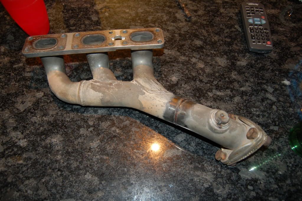

    Would these headers work good for my E30 M50 swap?
    I wonder if the stock manifold downtubes would work with em?
    thx

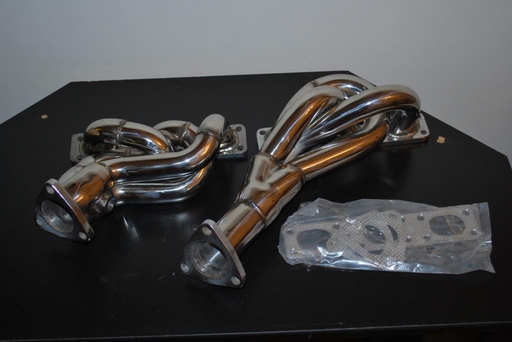

    Those are OBD2 S52 headers, will work with your swap, need to plug o2 sensors and secondary air ports, will mate up to obd2 midpipes with a little massaging. I am running said setup and it works just fine.

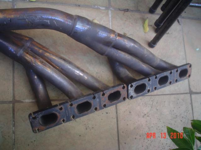

        Anyone recognize these headers? Guy wants $250, says he paid $1100 and they might be MSDS.
        Good headers? worth it? They came off his M3 LTW.

          /\ They look like my ss reps with more rust.

            I have the obd2 headers. To make them fit better, I cut the front header about 3 inches from the flange and clocked it so it wouldn't point straight at the subframe.

                  Those look like Genie headers to me.

                    Originally posted by hoveringuy
                    those collectors are crap, but so are all the other ebay headers people buy.

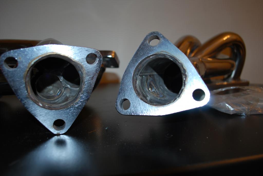

                        With the pipes just butting together in a straight cut like that, it doesn't matter much if they're short or long. most of the velocity is lost with the large void area in the center where the primaries join together. you basically lose any scavenging benefit a good header would provide.
