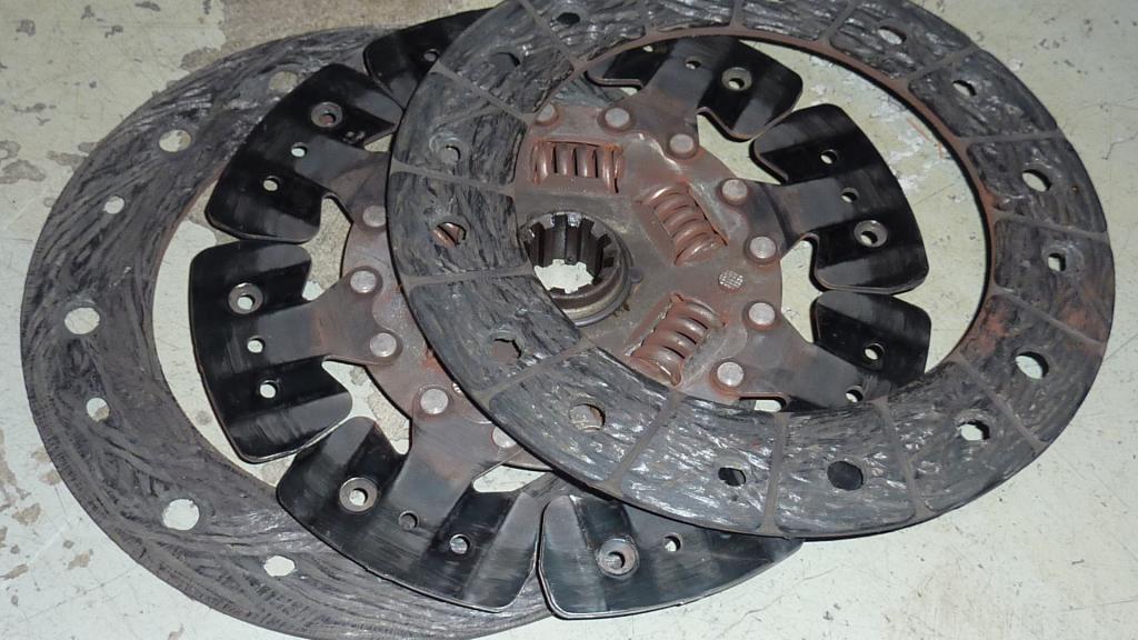

        Alright. About 5k miles later I missed a shift going from 2nd to 3rd. I didn't see exactly how high the rpms got, but it looked like around 7k. The remaining drive straps were bent. This was a 618.
        dead clutch #5 by jasapp12345, on Flickr

          Here's how mine failed. New, stock Sachs PP and clutch disc. M54 engine, 220ft-lbs torque. Some 1/4 mile passes.
          I replaced it with a Clutchmaster FX100 and I've been really happy with that.
