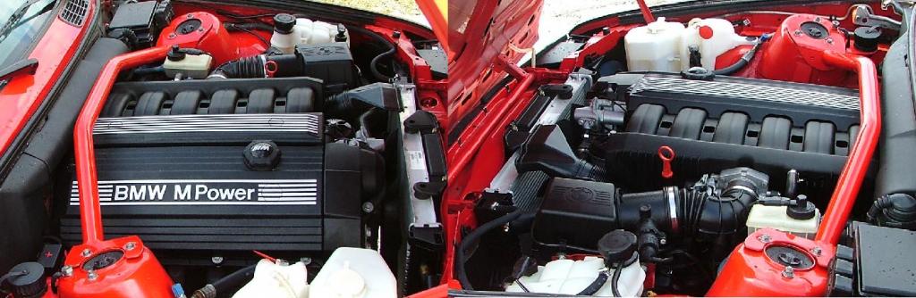

            #65
            I still think the factory look wins out
            "A casual stroll through the lunatic asylum shows that faith alone does not prove anything."
            Friedrich Nietzsche
            • bubbajan21
              • 1962
              #66
              Where is that airbox sucking air from? It's a little hard to tell in the pictures but is there a tube connecting it to the cover behind the headlights, or is it just open to the engine bay?
              • chuck90m3
                • 568
                #67
                Headlight sucking
                Friedrich Nietzsche
                • Jszy25
                  • 352
                  #68
                  ^ thats how I want to do my intake setup. OEM is cleanest by far.
                  Is that the M20 airbox minus the HFM?
                  91' 318is - OBDI M52/ZF swap w/ S50 cams
                  • chuck90m3
                    • 568
                    #69
                    Yes and opened up to accept the 3.5" meter
                    Friedrich Nietzsche

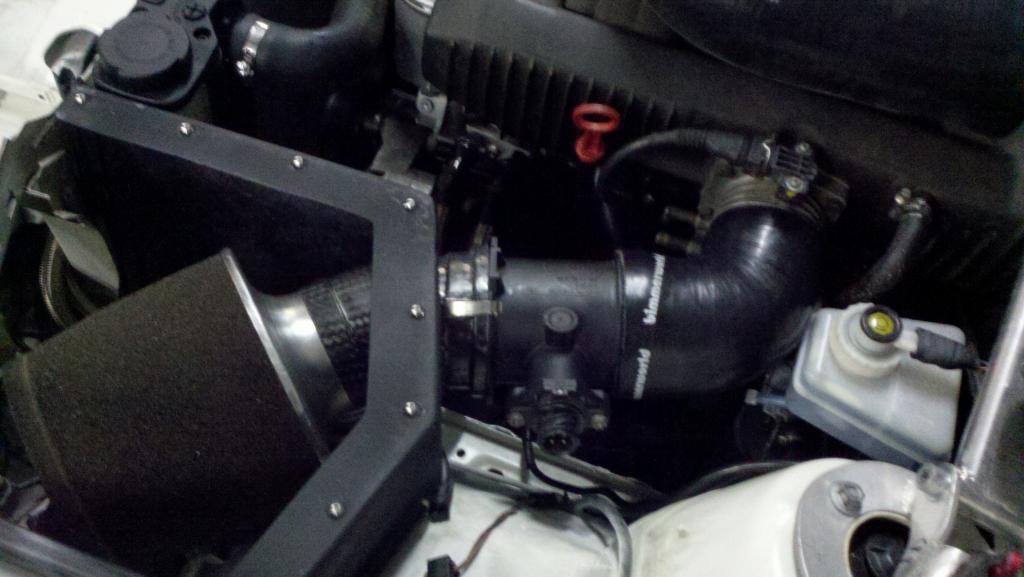

                              #74
                              Finishing mine up
                              • bubbajan21
                                • 1962
                                #75
                                Originally posted by mscott
                                Finishing mine up
                                That looks very nice. Are you going to have a cover over the intake? Looks very similar to the Castros box except it doesn't have a cover.
