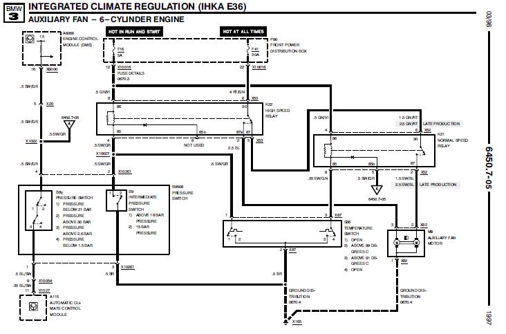

    See attached, only connection to dme is indirect through AC pressure switch. (DME controls AC which then can turn fan on)
      Thank you Dave, U da man! With the AC deleted I should be good as is.
