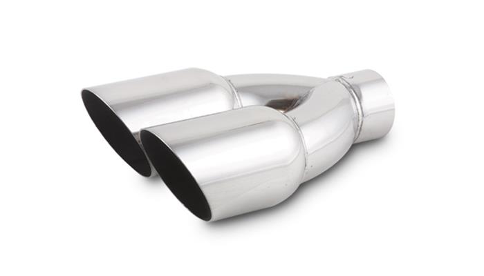

                        • TimKninja
                          • 2131
                          #42
                          Plenty of people make Tips.
                          For example...
                          Free Shipping - Vibrant Performance Exhaust Tips with qualifying orders of $109. Shop Exhaust Tips at Summit Racing.
                          Im probably doing a Vibrant Resonator TO a Magnaflow, to those tips.
