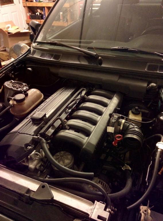

            #35
            Sent from my Nexus 5 using Tapatalk
            • NC325iC
              • Mar 2004
              • 6565
              #36
              Anyone else running the old style coolant res? How did you run the supply hose? I found one that is like the perfect length with a90deg formed end and just ran it across the top of the radiator.
