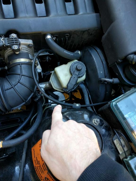

    I have an s52 with m50intake and s52 throttle body. I have the e34 throttle cable going to the bottom/smaller cam on the throttle. But the cable is way too long. I have one full loop around the brake reservoir area.

      Very strange mine has maybe 5 inches of slack on mine. Enough to make routing easy.

        #63
        Does it have the metal 90degree?
        Sent from my Nexus 5X using Tapatalk

          #64
          Yes I use the 90 bend.

            #65
            This thread points mostly to the e34 cable but talks about modifications. Anyone have more details of this?

              #66
              I think my memory exaggerated a bitClick image for larger version

                #67
                I don't recall but I think so. Mine is routed a lot different than yours. You can't see it from above at all. I think it goes under the MC rather than over.

                  #68
                  I think the issue is that the e34 throttle cable is too long. I have to loop it to get to the throttle body, and this could be causing the poor actuation. What cables are other people running? Any pictures?
                  I used 35 41 1 160 609 and it is long as hell, exactly as you describe, but I don't have any real issues with actuation. It could definitely be a little smoother, but I don't think it really affects my driving though.
