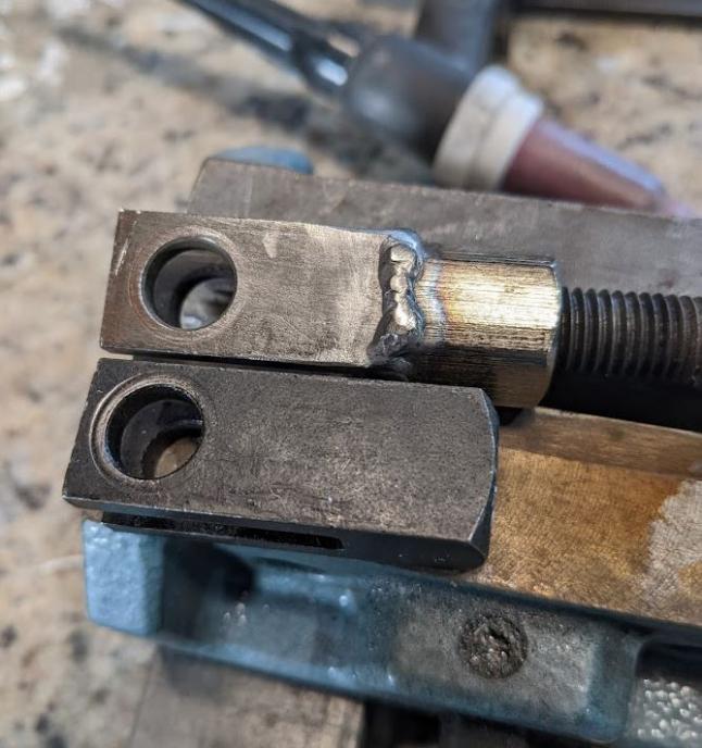

          Measured my stock one to 44mm, so it's 20mm longer. Das stimmt.
          I just added 5mm on to mine by cutting most of the stock threaded part off and gluing a section of 10mm hex coupling in place, added 5mm. Brake pedal now sits perfectly even with the clutch. An extra 20mm seems like way too much!
          50mm would be about perfect, IMO.

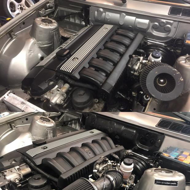

            I went with the E90 booster, But wanted to try the F10 reservoir just for cleaner looks, compared to the 2002 reservoir.
            I ran into issues with the M50 TPS hitting the reservoir.. So I got an M52 throttle which cleared the bottle, but the throttle cables hit the master.
            Picked up a RHD master from Europe.. made new brake lines..
            Now that all fits, but I realized the OBD1 cruise control cables dont work on the OBD2 throttle. I cut the rigid end off of it, and took the same amount of length off of the outer sheathing to compensate, and then "swaged over" the remaining rigid end after putting the "Tee" part back on. Seems to work.
            I did see a post or two on here about people modifying the servo end to make the obd2 cable work.. But I wanted to try it this way.

                For the clevis I simply measured the firewall to clevis distance on the stock e30 booster, and cut the ears off the e90 rod, and got the length correct on the old e30 “fork” and welded it into the e90 pushrod
                  I like that much better than welding the entire e30 clevis, it keeps the heat away from the booster.

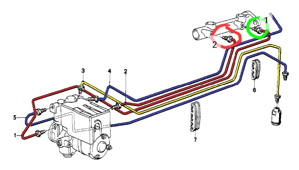

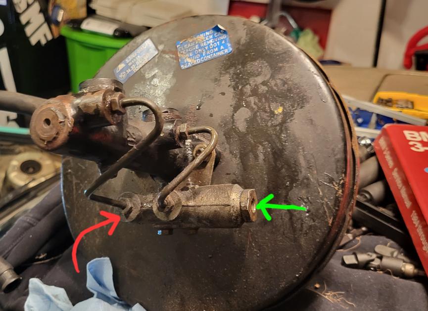

                          Cubby Chowder it looks like you have the ABS lines like I do and I dont know which lines to hook up to which ports on the e90 master.I have an '87 and I have an ABS system and lines still in place PLUS my lines were connected to like some stock proportioning valve.

                          ^^So this is what came in my car The green circle in the below pic was connected to the green arrow in the above pic, red circle to the red arrow....

                          ^^Here is the e90 booster in the car now with the unconnected brake lines from the ABS unit
                          OK, so I'm ASSUMING i will connect red circle to triangle OR star and connect green cirlce to triangle OR star. Someone help me please! I have line extensions and adapters ready i just need to know what goes where. THANK YOU!
                          Click image for larger version  Name:	Screenshot_20220608-224240_Chrome.jpg Views:	16 Size:	102.0 KB ID:	10058121
                          This is the last bit of info I have, this is the diagram of ABS lines, I have highlighted the green and red lines from my discussion above if this helps. I could NOT find an explanation anywhere of what these 5 lines are dedicated for.....
                            Sorry for late answer, but i will try to help...When looking that e90 booster pic where is that star and triangle and compare/looking this e30 abd brake line pic, so to me they go like this
                            -5=front left
                            -4=front right
                            -3=rear, first there is that pressure valve system, it is critical to have
                            So 2/red should go e90 to star and 1/green should go e90 triangle
