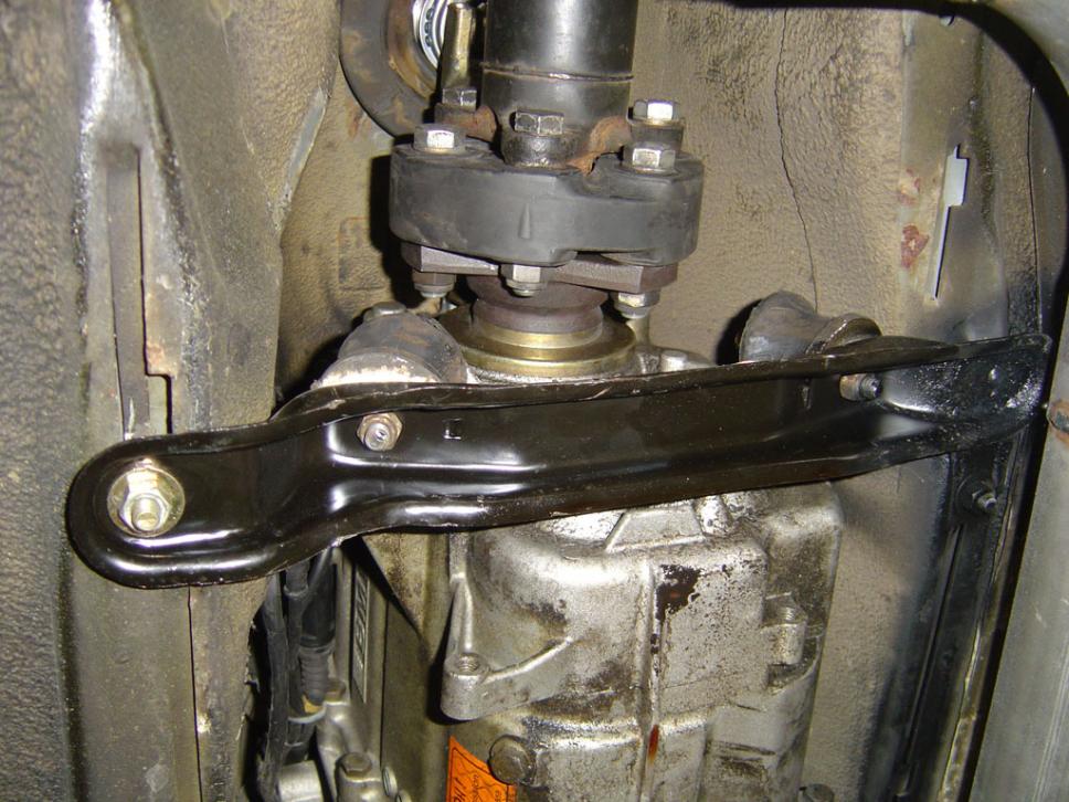

                              For those that did this swap, can someone please post some pictures of the modified cross member, and what they did? With the new info about not having to get a custom driveshaft made this is now a "must do" for me. I'm already running a 3.73 rear gear so I think this will be perfect for my car. Thanks, Christian.

                                This is a PIC i found off of the Azevedo Motorsports web page. It is just basically an extension from the manual brace rail to the brace that sits out in mid air. I am going to be making a few of my own brace (adapters) for myself and a friend. All you will need to do is bolt the (adapter) on the car and then bolt the brace to it. My adapter will bridge the manual to auto rail.
