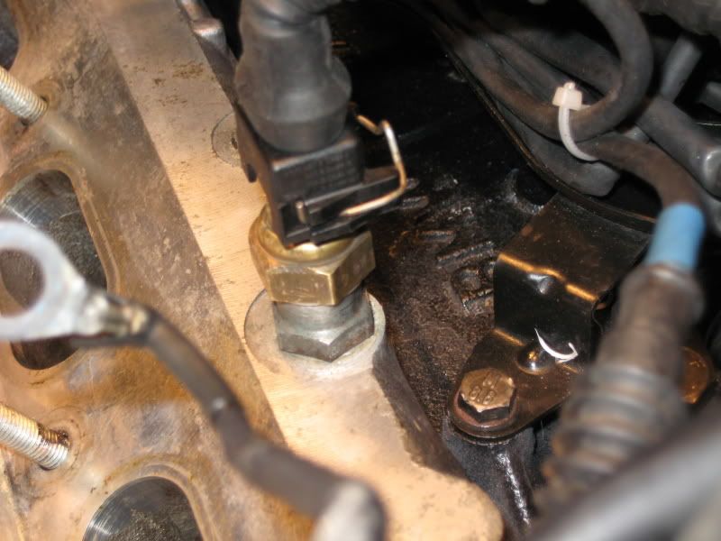

I tried drilling in as far as I could, but you could only go so far till the metal gets thin for the face that mates on the head. If I went anymore the threaded nipple would have literally came off the housing of the coolant feed. But what I did was I actually cut 1/4 of a inch of the thread off from the threaded part of the feed so that the probe was exposed about 1/2 inch within the head. This should allow it to read correctly and be grounded to the head.Leave a comment:
Looks good. Only worry is it'll read a lil off since the probe won't be in the coolant flow like it normally is inside of the head. But is easier so its a trade off. Looks like it worked out good.Leave a comment:
Picture of the adapter I made with a modified coolant feed that was chopped then hollowed with a 11/32nd drill bit to fit the probe and a 1/2 inch drill bit to tap the inside with a 14mmx1.5 tap where the sensor bolts up to. Worked out fine, just very tedious work. Little to no extra metal to waste so its a hit or miss. I did it right the first time so I got lucky.
-JasperLeave a comment:
Didn't tap the head. I ranked out. Lol. But I did do something better / safer and just as effective. I'll snap pictures for you guys. I already slapped it on but I'll probably fab up another one.Leave a comment:

Atleast I learned a few things before it went south. You guys cant seriously think its easier to tap a head (might not be that hard but its tedious) than it is to make a cut to a hose and use a few hose clamps...Leave a comment:
Can it be done without cutting oil or using some other form of lubricant?Leave a comment:
Use cutting oil it is only aluminum and will drill/tap eazy.
Exactly the answer I was looking for. So essentially it would be more of a hassle to rethread a sensor than the head? I'll just tap the head. Already bought the drill bit and tap. Any suggestions before doing so from any experience person's point of view?
Also, my biesan systems kit came in today, after finals on wednesday I'll be tapping the head and rebuilding the vanos unit. Thanks for the response.Leave a comment:
