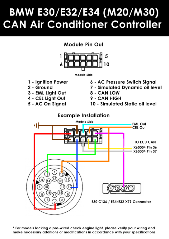

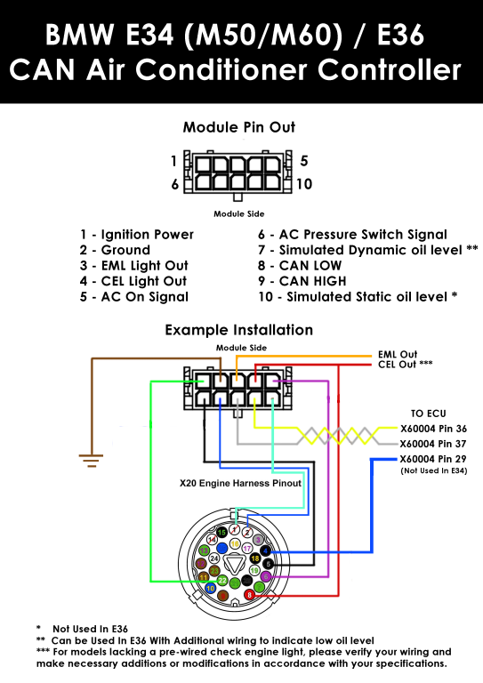

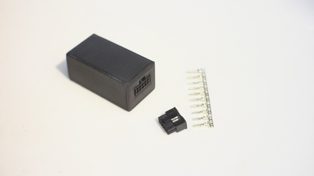

    M54/S54/S62 to E30/E36/E34 AC Controller
    Hello
    Can Controllers Available to Enable ac and CEL , EML and Low Oil level lights on engine swapped cars. uses all stock sensors and switches and all connection can be done through X20 Connector.
    can be used with any engine that came with E38/E39/E46/E53 From 1998 and up.
    price $150+ Shipping​

        Basically you can keep all existing wiring and pressure sensors and keep original HVAC unit to control ac compressor and can unit will inform the ECU to rise the rpm. Also you can rewire just the ac compressor relay to ECU and let the ECU control the ac compressor too with the added benefit of full load cutout and high coolant cutout done by ECU.
        Alternatively you can use ac control as a 2nd map switch for the ECU too by changing fuel/ spark maps for ac compressor too.
        This unit also decode check engine, electric throttle and oil level data and convert those to use with regular bulb outputs so that can wire to any indication light on the dash.

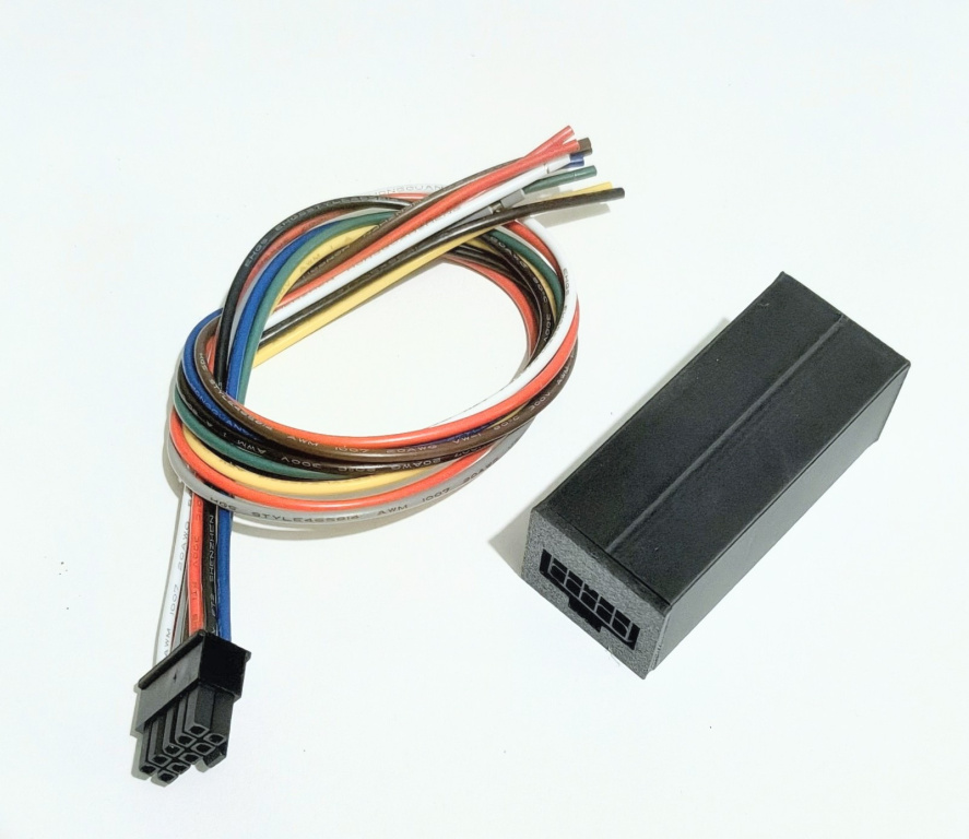

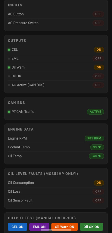

                        New V2 version now available with added wifi functionality to monitor and test inputs and outputs also now available with the pre made connector harness for easier install.
